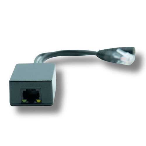

I got one of these and wired it to the cars 12v battery:
Then got an oldschool HW1 Pismo Rugged (thanks @Rick-DC !), then hooked up the Rugged to the LAN1 port on the max and the problem was solved, signal now reaches as far as 150 feet outside and around the truck, with perfect quality and even with the rugged being placed under the seat INSIDE this is using the stock antennas.
