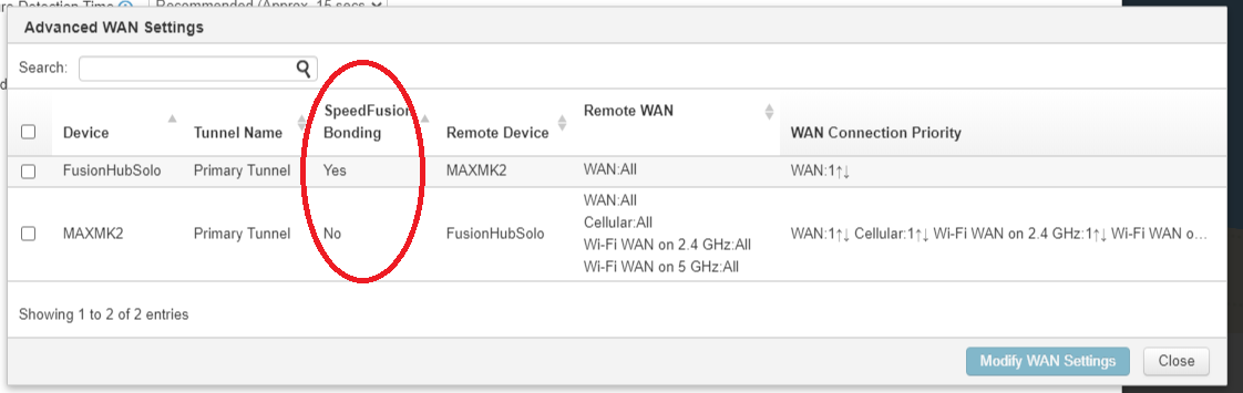

Also see this I dont know if SpeedFusion Bonding needs to say Yes for my Peplink device? I can’t find where to change it.
This spec sheet suggests that that device doesn’t support bonding, but instead failover only…
See here: https://www.peplink.com/products/max-cellular-router/single-cellular/
It supports Speedfusion Smoothing
I am trying to enable Smoothing
Hopefully someone from the Peplink team can chime in and clarify for us. Normally under the SpeedFusion profile you will see a WAN smoothing and a forward error correction drop down box.
I have enabled Wan smoothing and there is an option to enable forward error correction…

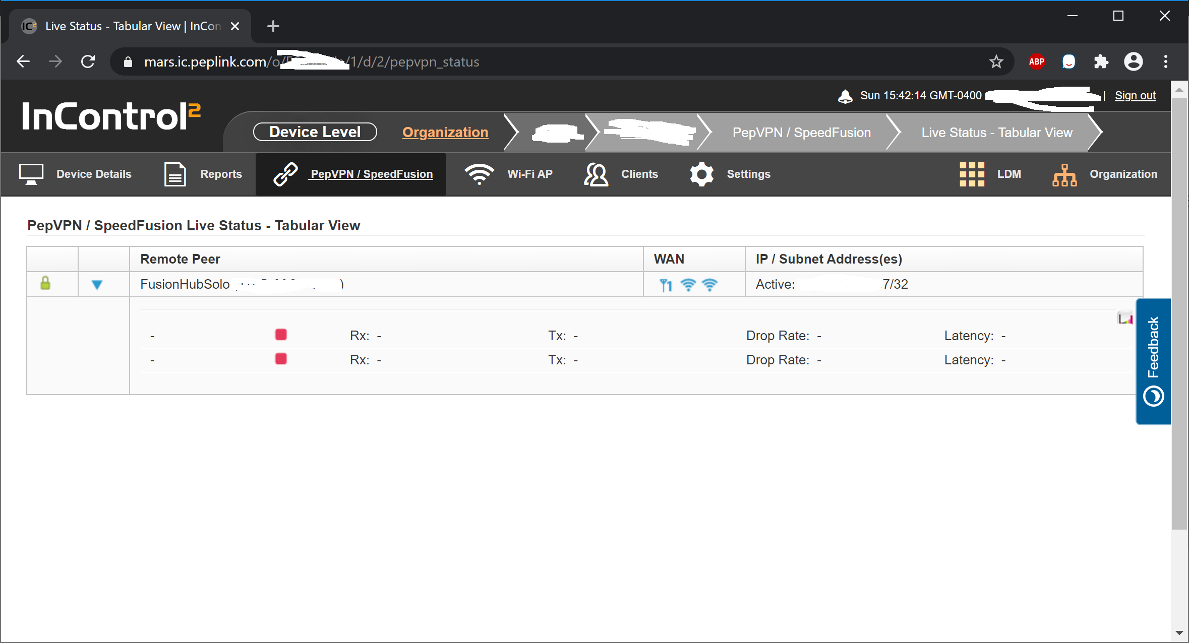

Suspect this is a UI issue. The device doesn’t do bonding, so the other WANs are in standby for bonding, but WAN smoothing is supported. If you run a speedtest do you see traffic on the links that currently show as on standby?

@mystery, I am looking into the problem you reported here. I will continue to look into the problem of WANs show standby in SpeedFusion statistic while WAN Smoothing is enabled.
@mystery
I’ve tracked your issue with smoothing not being enabled on your device to an issue with the config generation code. It’s a minor fix and should go out to production sometime today.

Something weird…
I was looking at my MK2 device: Status > Speedfusion and saw all WANs working (after your bug fix was applied), however, I logged into IC2, and noted all were no longer in priority 1 as I had set, and they were priority 1, 2, 3, 4, with the cellular in a higher priority.
Thinking that might be the issue, I re-set them all to priority 1. Pressed save. Then my Speedfusion connection went down.
Previously, at your advice, I had setup the Speedfusion profile with Star topology and the Hub set as the FusionHub Solo. Somehow now they have swapped and the Hub is now the MK2. I may have accidentally selected the MK2 from the dropdown at Edit > Device in IC2. Since I needed to get the Speedfusion tunnel back online and I could not find any way to change the hub back to the FusionHubSolo, I deleted the entire profile and re-created the connection.
