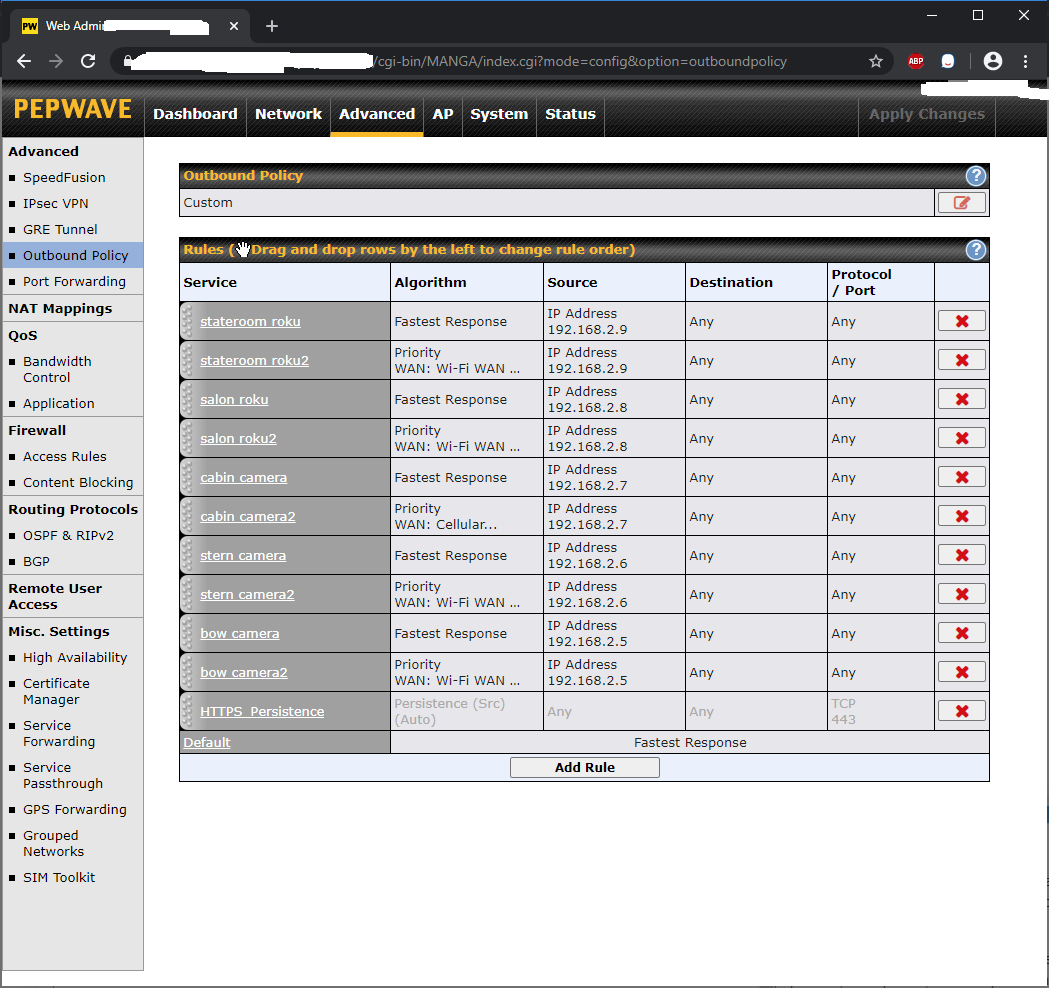

So the rules (see attached screenshot) have been working well. I typically have three WANs all in priority 1 when the boat is in its home port: WiFi as WAN 2.4ghz, WiFi as WAN 5ghz, and Celullar. TV streaming & security cameras connect over WiFi as WAN (except when there is no WiFi as WAN, then cellular is allowed) and all other devices have use of WiFi as WAN AND cellular at ALL times for Fastest Response.
What I’d like to do now is add Speedfusion Smoothing for “all other devices” which are mainly cellular phones, VoIP phone, and computers that do voice and video conferencing. Two purposes: 1) so they have a more “stable” connection, 2) so data is encrypted as some times the WiFi as WAN connection is an Open/insecure network.
Can someone please help me understand how I should tweak my rules to route my “all other devices” traffic over the Speedfusion VPN? And if for some reason, the Speedfusion link is lost/unavailable, it defaults back to how things currently are setup (i.e. I dont want to lose access if Speedfusion stops working).
Thank you in advance!!
Just above the Default policy (at the bottom of the ruleset) add a new priority rule for any to any with just the speedfusion link active. Then set ‘When No Connections are Available’ to ‘Fall-through to Next Rule’.
Wow, super easy! Now I am just trying to figure out why my WiFi as WAN are in standby per the attached screenshot? I enabled smoothing on IC2 which allowed me to set the WANs all to priority 1, I saved the changes, but I am still seeing the attached.
Check the priority on the Dashboard page.
The SpeedFusion profile on each side of the connection has priorities inside of it, could one end have those 2 at a lower priority?
