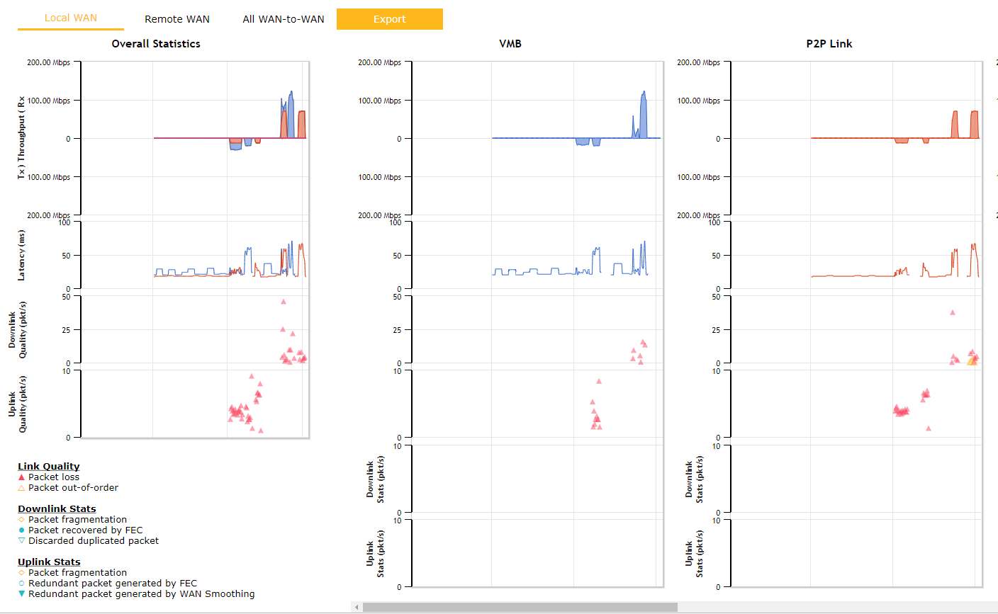

First thing to do is use two tools to test your SpeedFusion connection. The first is to start the graphs, the 2nd is a SF speedtest.
Navigate to Status > SpeedFusion. Find your Cloud Connection and click the graph button. Then click the arrow button:
- The graph page should open in a new tab - leave that for now we’ll come back to it.
- The arrow button should open up a PepVPN details window showing your available links.
- Click the show remote connections checkbox and then you get toggle buttons next to each WAN.
- Run a 20 sec TCP upload speedtest.
- Run another with just one connection enabled, then another with the other connection enabled by itself.
- Then repeat for download.Screen grab the graphs and post here.
eg here is my set of tests against a SFC in Amsterdam (I’m in the UK).
These graphs take a bit of interpretation. Mine shows me that although my upload bandwidth is bonding well, download is not working as well. Combined download bandwidth is around 100Mbps whereas separately WAN1 can do over 100MBps and WAN2 can do 70MBps. If I really wanted to chase down the underlying issue here I would look at why there is so much packet loss first and try and fix that. Packet loss on a link is the biggest cause of underperforming bandwidth when using SpeedFusion.
Grab your graph and share it and we’ll see if we can make some recommendations.
