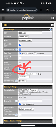

Ok I found what I think the issue is , please try pings again.
Apparently by default later 2 isolation is on.
To further make it more frustrating it’s a hidden option.
See screenshots.
@sitloongs , can you file this behavior as a bug.
That is a bit infurating that it was hidden. It was a recommendation I found surfing through the Pepforums but they were so old i figured it was outdated info.

Layer 2 isolation wouldn’t effect outbound traffic.
Are you referring to the default behavior the L2 isolation option is enabled condition ? If I remember correctly, this is the old issue which have been fix. Potential it can be config that migrate from the old version.
Can you help to confirm this by create a new SSID and verify whether the option is enabled default ? We can sure improve this if the issue persisted.
New B one , New SSID , New config.
Thank you for confirming and I will check on it,
