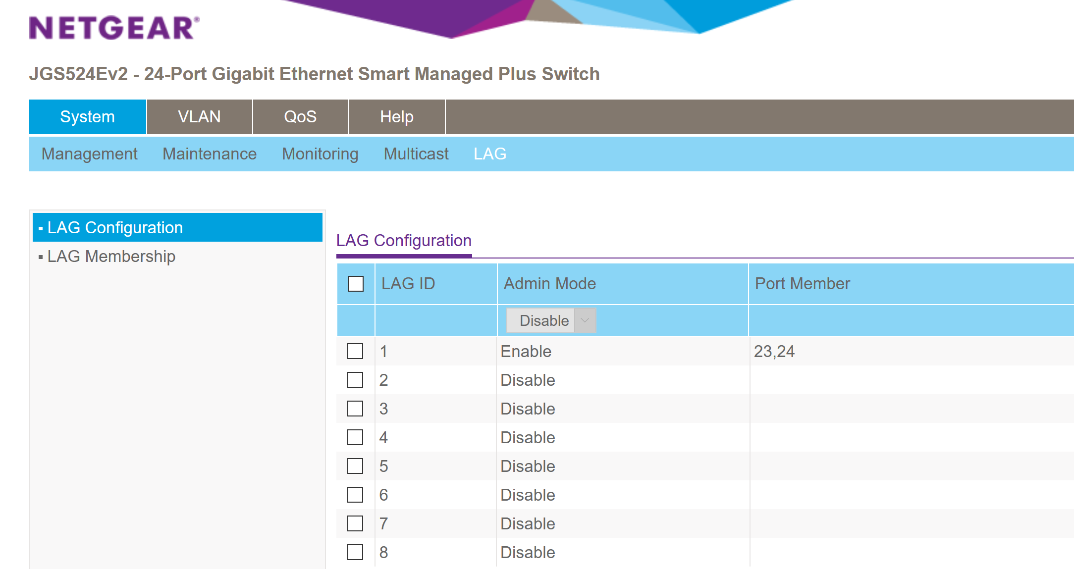

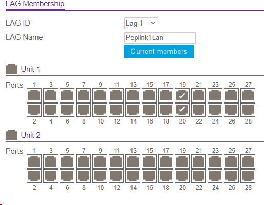

Hi. I would first plug both cables from the 305 LAN ports into the same Netgear switch. Then, one must set up a LACP group on that switch. Not sure which product you are using but that’s what we do with the Netgear switches we have in service. If you are stacking switches you can then set up a second LACP group between switches.
Thanks! I am trying it now (just waiting for Remote Hands to add the cable). These switches have a lot of LAG options. I’m not sure what everything does. Googling what others have done, it looks like the defaults should be fine.
So I have Peplink1 LAN1,2 going into Netgear1 and Peplink 2 LAN1,2 going into Netgear2. It looks like it would be possible to have Peplink1 LAN1 goto Netgear1 and Peplink1 LAN2 go to Netgear2. (and the same for the Peplink 2).
I’m trying to think if that would be a benefit. I suppose if one of the switches went down, the Peplinks would still be able to communicate to what’s connected to the other switch. I suppose it’s also possible to connect LAN3 to the other switch (and add it to the LAG group). As it stands now, if one of the switches when down, I would need the Peplink to failover to the other unit.
