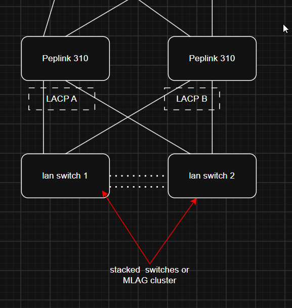

So we can connect 1 (or 2) 310’s resiliently to the lan side switches.
We usually have stacked or mlag on the lan switch side (extreme 4220/5420/7520, hp flexfabric, meraki ms220 etc).
Like this:
We can do that for SDX, SDX Pro, 1350EC, 310 5G (previous model)… even the br1 pro 5g supports it. But not the new balance 310 (or the B One 5G).
It would be nice if it was like HA, supported on everything… but the 310 is the biggest place we miss it, as the old 310 5G had it and the new 310 does not (I am aware the new 310 5G HW3 does)

@bryn.loftus we have prepared a special firmware (8.6.1s003) that added LACP support specifically for the Balance 310-HW5, you may download it here.
I have briefly tested it and it should be working. You may try it out and share your feedback with us.

  • Switches that can do multi-chassis lacp (so stacking or mlag). We do this part with Extreme/Meraki/HP or other switches that have that capability.
