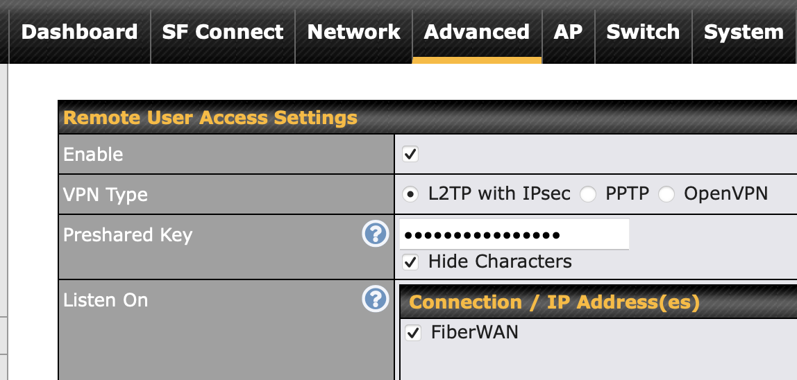

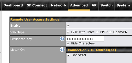

I have a Balance one running firmware 8.5.2, and starting this week some users are unable to connect to the balance which is running Remote Access using L2TP:

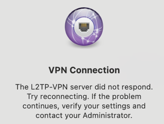

So far, it seems that clients running iOS 18.6 and macOS 15.6 get a failure to connect:
but clients running iOS 18.5 and macOS 15.5 can still connect.
Nothing else has changed, other than those OS updates.
When the connection fails, the Peplink shows nothing in the Logs.
