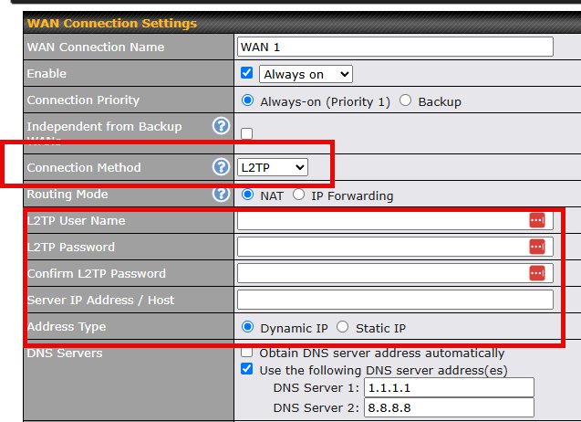

Actually L2TP is already supported on the WAN. You may want to give that a go :slight_smile:
Hi Martin,
Thanks for the welcome and for your response. I am aware that this is an option for the Ethernet WAN ports but it would be useful to have L2TP as virtual WAN option as for example I would need to tunnel L2TP over the Cellular connection.
