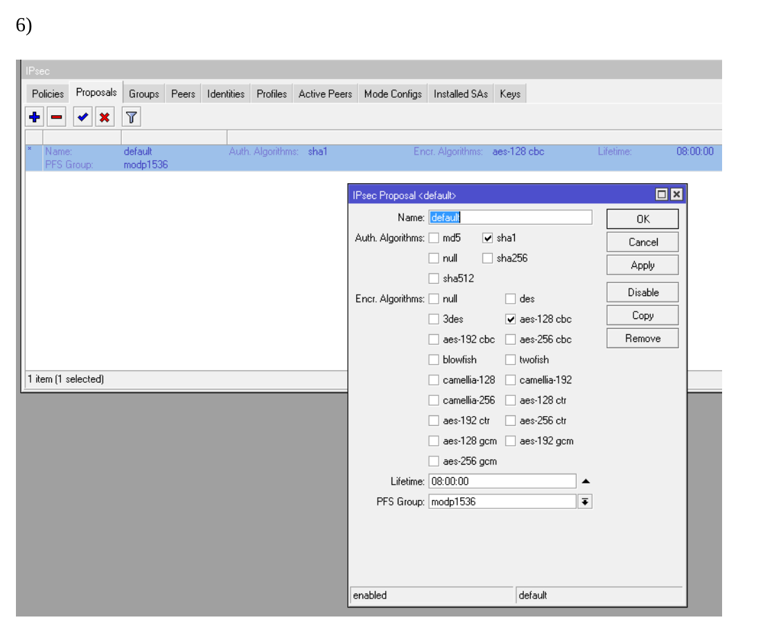

I also close IPSEC with Mikrotik, without issues.

Hello.
Keeping it simple…
Ike v1 / v2
Follow a sample with Teltonika.
Thank you. I will try and replicate.
Tried similar settings but im still not successful. Could you elaborate your settings for Local ID and Remote ID?
hello.
You need to adapt this configurations for your WAN / LAN ip address.
