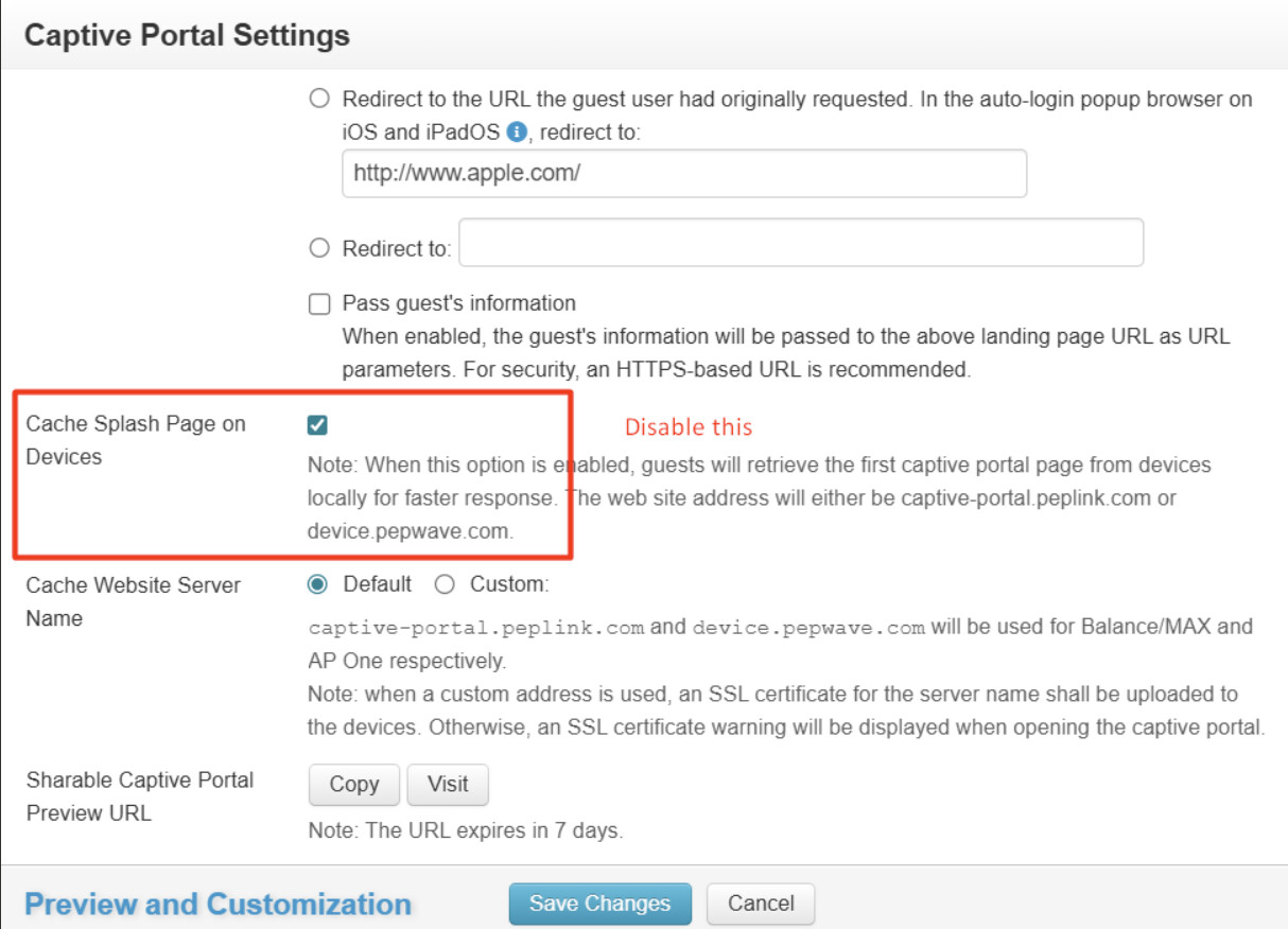

Currently, we are facing this issue with Captive Portal.

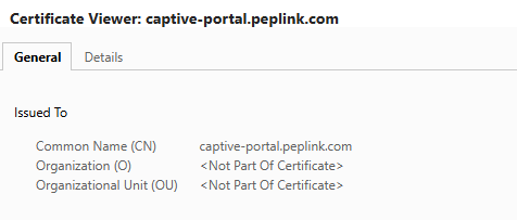

The captive portal is not showing up as the certifcate is not secure:
The certificate is showing :
captive-portal.peplink.com

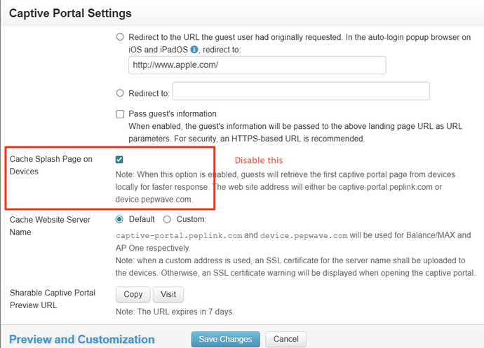

I had simmilar issue what i did was remove captive portal, reset balance and creat new one.
The issue is resolved with Peplink Support.
Based on further testing, the issue might be the certificate in 8.5.3 Build 6030.
After upgrading to that build, the captive portal is broken.
We have to downgrade it back to 8.5.2 Build 5862 so Captive Portal is able to connect.
