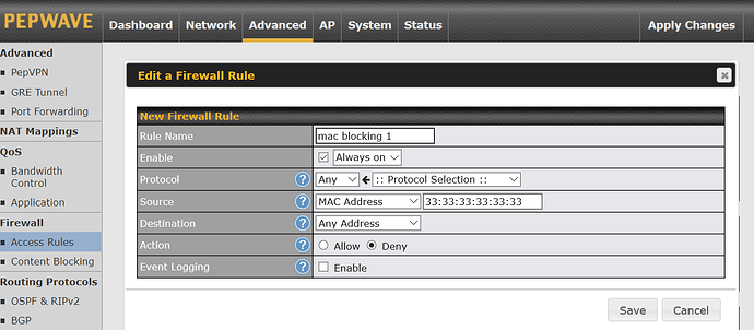

I have tried setting firewall rules on the Internal network to isolate specific static IP and/or MAC addresses from other LAN clients, but I am still able to ping the fire-walled devices. I have tried setting them up as source and then as destination, but nothing stops the traffic.
What am I doing wrong?

The clients are all on the same subnet. I am using my previous routers as wireless access points. I am using the guest network for my IOT devices. I have the option to allow guest to see each other. That option is is turned off and it works to prevent those devices from seeing each other, but the can still see my local network devices.
Thatâs why I tried setting firewall rules on the Internal network to isolate those specific static IP and/or MAC addresses from other LAN clients, but I am still able to ping the fire-walled devices.
The firewall is not denying access to the internal network devices.
Could the access points still be allowing this to happen?
Thanks, Dave

You made this type of internal firewall rule to block the IoT device from talking to other devicesâŚ
So that covers one IoT device â all other devices.
But then conversely you would have to do the same thing for each of the other devices on the subnet to prevent them from being able to ping the IoT device. Thatâs potentially a lot of rules!

No, it wonât. Firewall works between subnets. Two devices on the same subnet can talk directly to each other - they donât have to go via the router to communicate so the firewall canât have an effect.
wifi client isolation works because it is performed at an access point level (the AP acts as a wifi networking âswitchâ and effectively puts all clients into their own VLAN).
Put your guest wifi clients into their own VLAN, then block that VLAN from accessing your other LAN clients.
