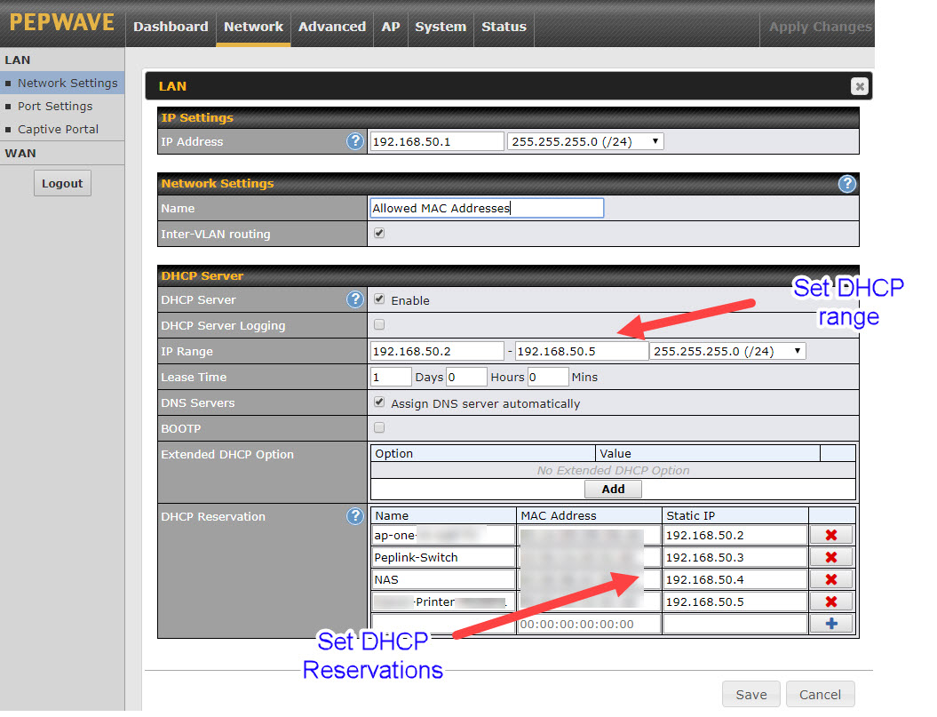

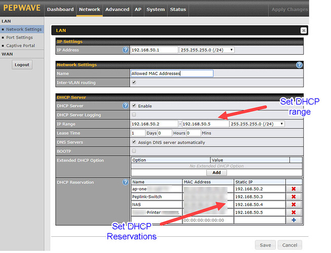

You could also create DHCP reservations for the MAC addresses you want to allow, in theory then, any other MAC address would not receive a DHCP IP address. I’ve given an example here:-
