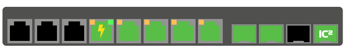

I’m still not sure what we’re doing wrong here. Both switches have a port labeled with the IC2 icon when viewed from the SDX local switch controller (image below), but neither shows up in InControl2 with all of our other gear at various sites. Both switches appear in the Offline Devices column. We don’t have Outbound Firewall rules or anything unusual in that sense.
