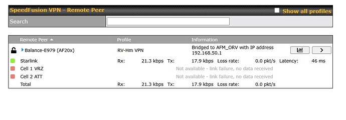

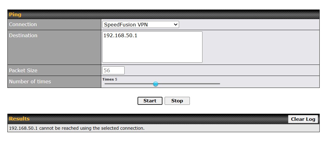

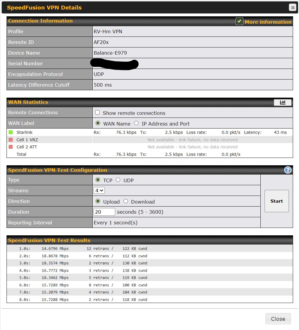

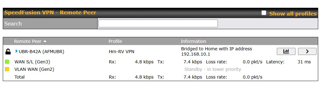

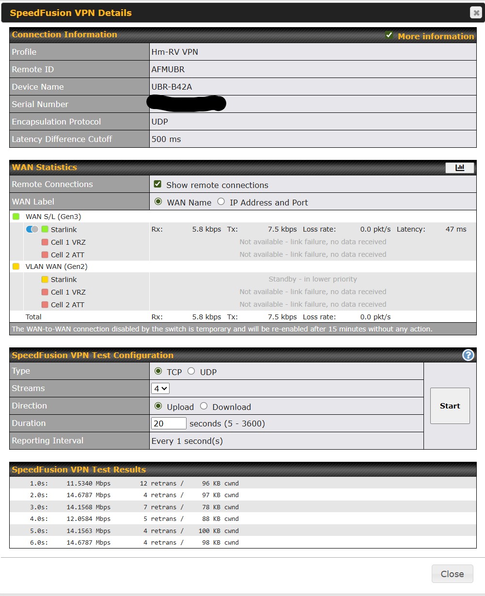

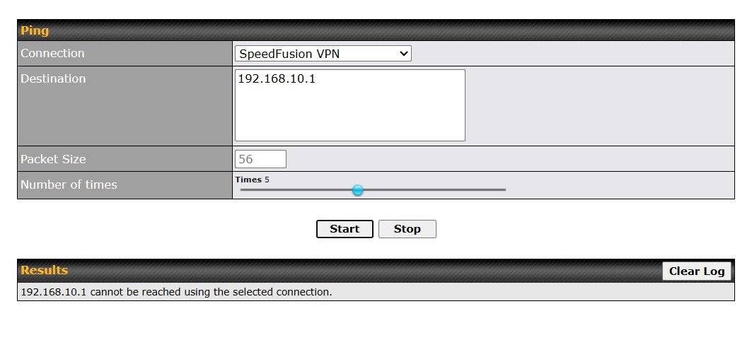

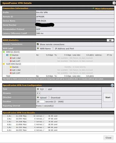

L2, (all the instructions/vidoes show setting up this type)
Please see attached pic’s, hope I’ve provide what was requested.
@Kirk_Almquist ,
For the ping tool test & VPN tunnel status , I’m seeing you are ping 192.168.50.1 & 192.168.10.1 . This is not a expected IPs for L2 SF tunnel which allowed to communicate.
(LAN IP) 192.168.50.1-B20 <---- L2 SF----> UBR -192.168.50.2 (LAN IP)
|XXXXXXXXXXX________192.168.50.0/24____XXXXXXXXX____|
For L2SF design (Refer to the design above), expected both end LAN networks are running 192.168.50.x/24. You can use the ping tools to ping the LAN interface IP for the remote device.
L2 SF is like network extension (192.168.50.x/24) to remote network.

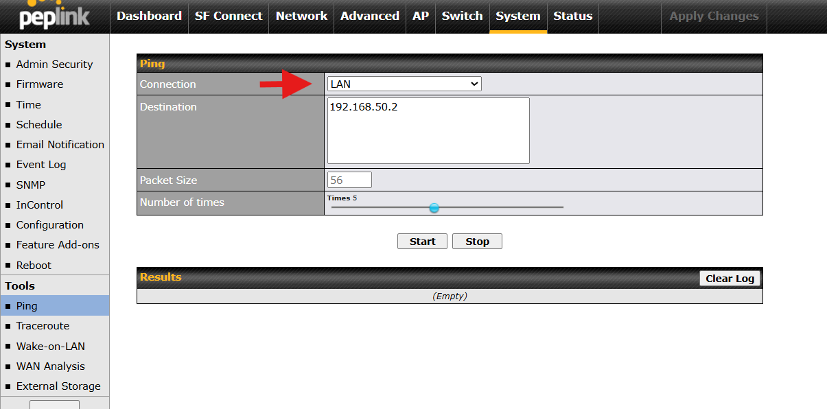

Suggest you can change the 192.168.10.1/24 (LAN interface IP) to 192.168.50.2 and redo the test.
