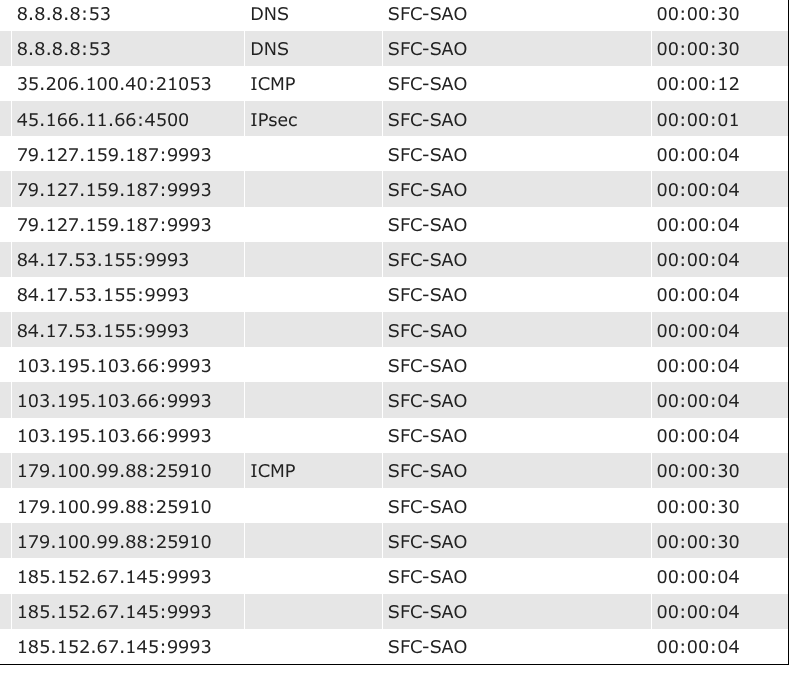

Thanks for the post, how are you using ZeroTier? We have the Speedfusion VPN to Speedfusion connect, the customer is connecting their fortigate firewall on the B One LAN and its creating an IPSEC VPN through SFC to their other site (Non peplink). weirdly the web interface of a device is not accessible, doesnt load correctly, through the ipsecVPN, but remove the peplink device /SFC Tunnel and the web interface works thought he IPSEC VPN, feels like some packets might be getting mangled and the Web Interface isnt handling it… i’d tried enabling FEC on the SFC, but this hasnt improved anything

Peplink outbound
RUT240 (Zerotier) → LAN → BR1hw3 → INTERNET → SFC → INTERNET → ZeroTier → RUTX12 (Zerotier)
RUT240 (IPSEC) → LAN → BR1hw3 → INTERNET → SFC → INTERNET → Firewall (IPSEC)
