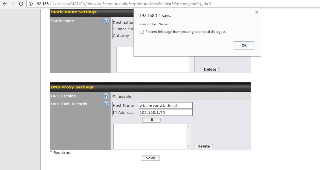

Invalid Hostname error in DNS proxy
Model: PePLink Balance 710
Firmware: v4.1.0 build 1068
I am trying to add a host entry in the dns proxy settings but pep link is not accepting my host name, i also tried other host names but still the error is there.
please find the attached image.
I wonder if this is a problem with the firmware. I tried the same host name on a 6.3.3 firmware 580 and it added it fine.
I would suggest upgrading to the latest firmware and trying again.
