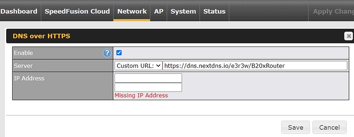

Update: I tested with a NextDNS url and that was not enough. As shown here, the router wants an IP address too. Why? The server/host name/URL is all that NextDNS needs in any other environment.

@Michael234, I have checked the updated user manual, it stated the DoH will take precedence if enabled.
On the DoH settings, if you select the predefined DoH server, the router will refer to the associated provider DNS server IP addresses (as per the description above) embedded in the firmware. While using the [Custom URL:], the router needs you to manually enter the provider secured DNS server IP addresses.

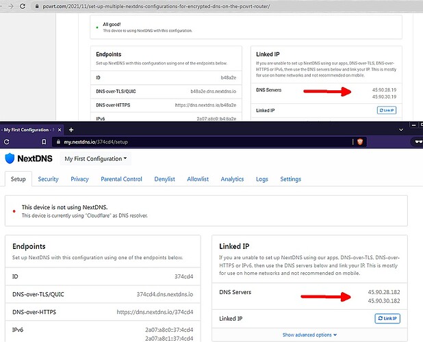

I see from this article, NextDNS server IP is 45.90.28.19 & 45.90.30.19.
DoH takes precedence over what? The description you highlighted is about DNS requests leaving a WAN port going out to the Internet. The second sentence says it will not send UDP port 53 out the WAN port. Fine. But, Local DNS requests do not leave the WAN port. Thus the question of whether Local DNS records are honored or ignored when using DoH.
Update: Testing whether Local DNS records are being processed or not is simple. I tested it and even when DoH is active, Local DNS records are processed and used.
NextDNS differs from other Secure DNS providers in that they do not have just two IPv4 addresses. They have a pool of them. You can see this yourself in this screen shot which shows the article you referred to overlayed on a brand new NextDNS account that I just created. The IPv4 addresses differ.
So again, why the need to specify an IPv4 address (or pair of them) for DoH? Every DoH and DoT DNS provider says to use a hostname.
