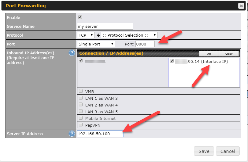

When you set up port forwarding you get this interface where you can select the port, the WAN IP and the internal IP:
Is that what you did?
yes, exactly that.
It doesnt seem to recognize porr 8080 but just goes to port 80 which goes to my IIs webserver itself.
