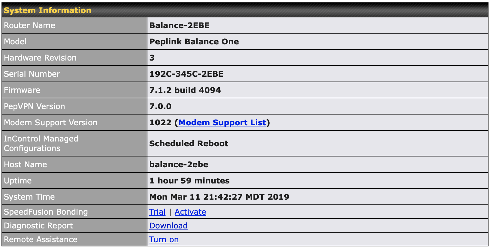

Thank you for the quick response. See below:
image cid:[email protected]
@valltech
Internal Firewall Rules can’t block the traffics destination to the Balance One Interface IP. You need to test the firewall rules by pinging to the devices that connected to VLAN 60.
Can you test on it again ? You can enable firewall logging for the firewall rules and this should give you the related logging at the event logs page:
