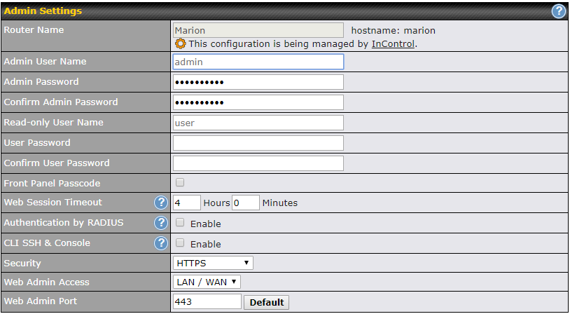

I’m unable to log into one of my four Balance 305s via InControl2 but can login without issues via the WAN IP address. All of my Balance 305s have the same general configuration.
The configuration is clearly being managed by InControl2 as shown above. The connection simply timesout when trying to access via InControl2 for this device regardless of whether any bandwidth is being used on any of the WANs or not.
