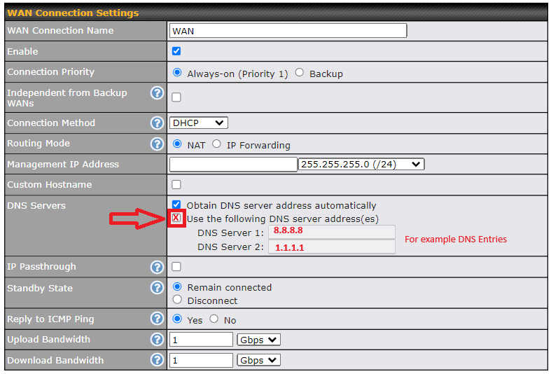

It is possible that Starlink automatic assigned DNS is not able to resolve InControl cloud platform. Suggest on the WAN setting enable and change to any other public DNS IPs . Hope it helps
