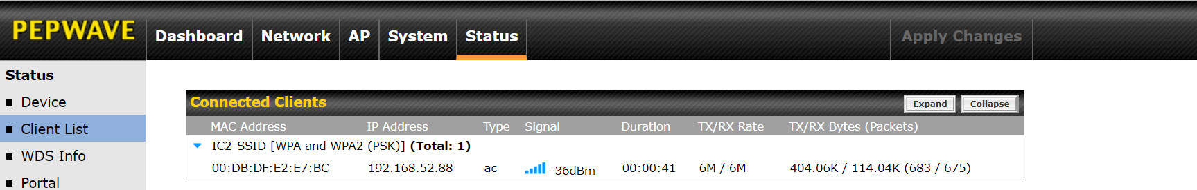

My laptop managed to connect to 5GHz that broadcasts by AP One Enterprise. Please find my screenshot below:
Can you provide the similar screenshots in order for me to understand better of your configuration in InControl2 and the connection status of the Wifi client? Which AP you are using now?
