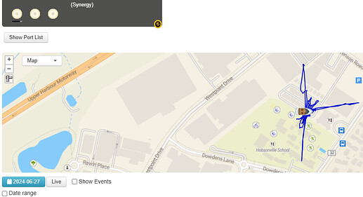

It looks like GPS data go about a week back in InControl 2:
Heya!
Just looking at some devices in IC2 and I have devices with several months of GPS locations… All the way back to June 2024…
Right, in I2C everything looks fine. But my understanding is that locally on the router’s admin web interface there should be 7, not only 2 days of GPS data?
I can confirm on the few random devices I checked, I can only see today and yesterday, with lots of data in IC2. My recommendation, file a ticket as a bug, and use IC2 ![]()
