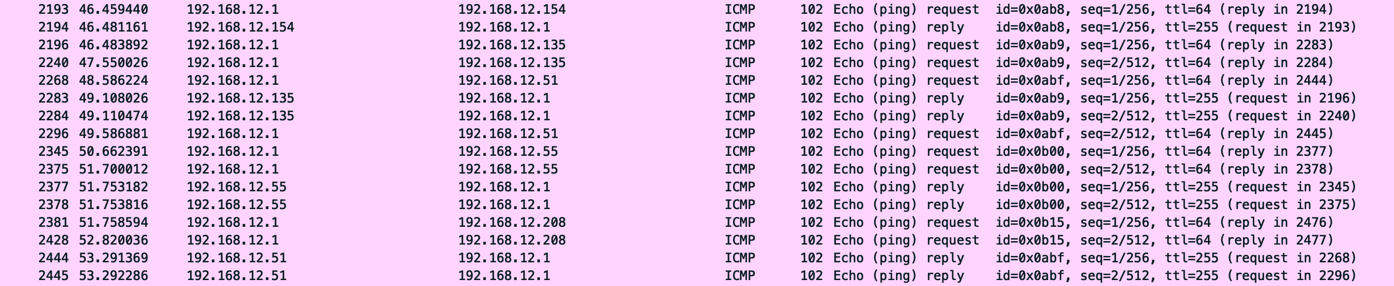

They are on a separate VLAN, and after a packet capture, I noticed the router is pinging each lock every minute, which causes the locks to wake up and respond, wasting battery.

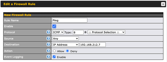

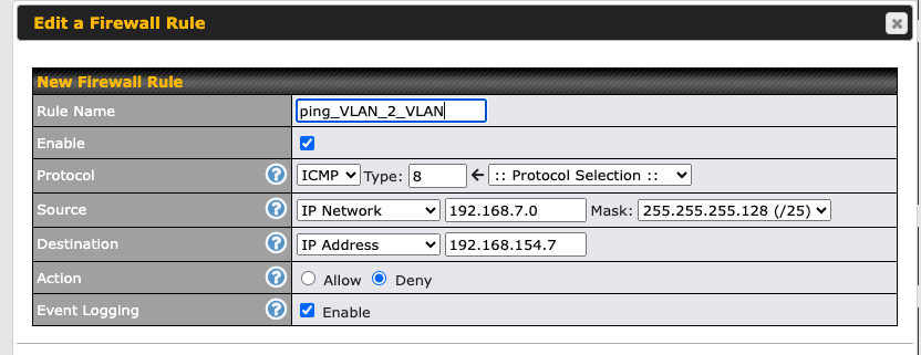

Hi, @fvideira
Have you enable…
Screenshot 2025-07-28 at 15.25.33

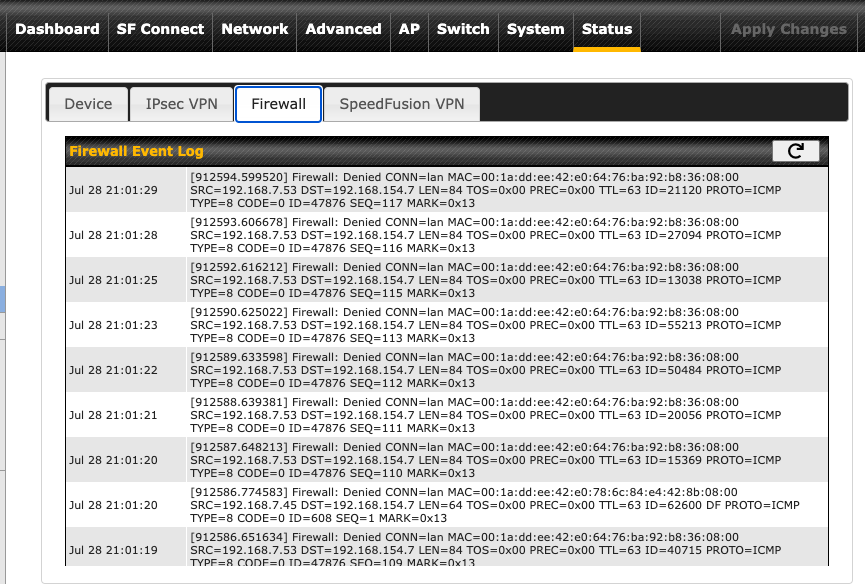

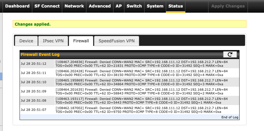

So… this way you will have a screen like this.

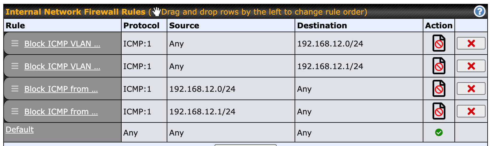

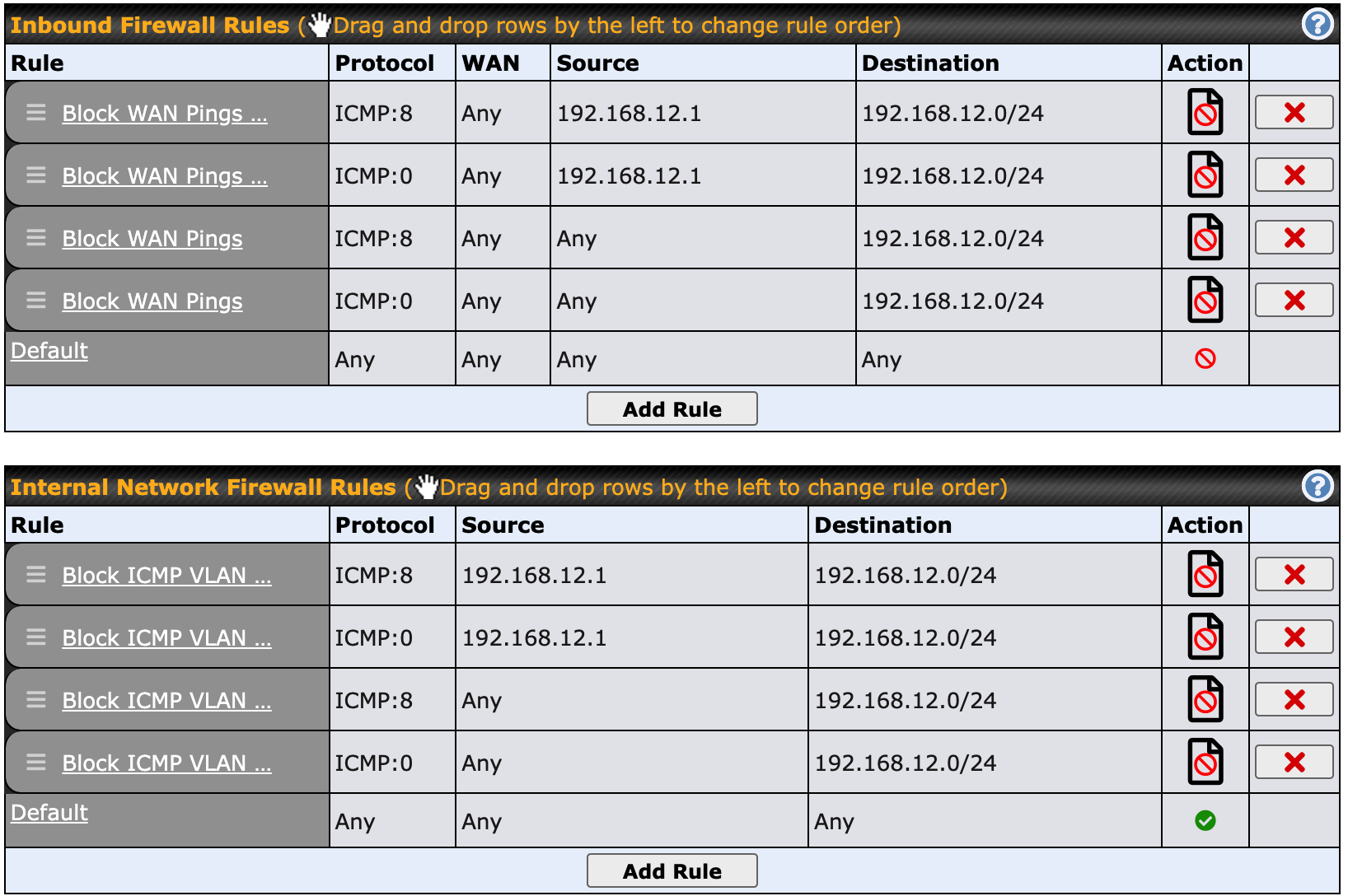

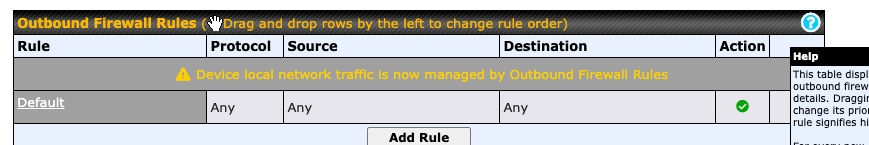

I have already set up the rules for internal networks.

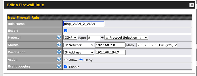

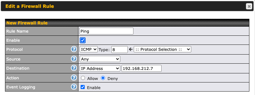

I even set up some extra rules (two on the bottom) as I don’t want the devices on the 192.168.12.0 to send or reply to ICMP requests. The devices are on the LAN side.
icmp:1 ??
But… echo request it is icmp:8 !
and echo reply is icmp:0 !
Google
The first byte specifies the type of ICMP message. For example, type 8 is used for an ICMP request and type 0 is used for an ICMP reply.
AND
VLAN_TO_VLAN
ICMP:1 should block all ICMP traffic, as per Peplink’s menu
I have tried 0 and 8, both for the Inbound and Internal firewalls, adding the subnet and gateway, but it did not work. I still see 192.168.12.1 pinging and devices replying on the 192.168.12.0 network.

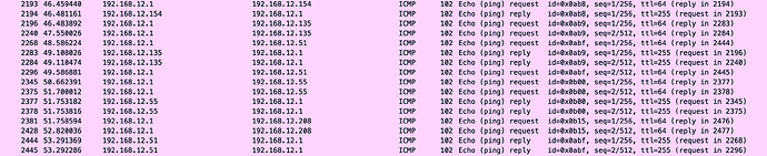

Here is a packet capture:
Do you have any other ideas? Could it be a firmware bug? I am running 8.5.2 build 5862.
