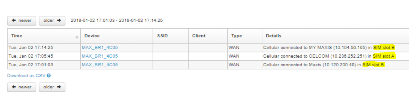

Guessing this is on single cellular WAN with redundant SIM card deployment that customer need to know the SIM slot connected info.
For device firmware version 7.1.0 onward, we have enhance the device event logs to include the SIM slot connected info. Below are the sample event logs shown:
WebAdmin Event Logs:
IC2 WAN Event logs:
Email Notification In IC2 Cloud
  • Just having a discussion with Engineering team , do you think the connected SIM slot info embedded in the Cellular WAN Up notification sufficient for your use case ?

Yes, Engineering team is looking and considering the request. We need input from you guys on the notification email content that would help for your use case.
Below is the sample for the current version email notification for “WAN UP”:
Do you think by embedded the SIM slot info into the above “WAN UP” notification is good enough?
Example (For Reference Only):
“Pepwave MAX BR1 Mini” - MAX_BR1_4C05 (2933-20E9-4C05) - Connected to T-Mobile (SIM A) on 2018-01-02 17:14
Or you are totally looking for a new email notification email with different email subject line?
I would love to see it say “MAX-BR1-Mini-XYZ is now connected VIA SIM slot 2 166.123.234.23” or “MAX-BR1-Mini-XYZ has failed over to 166.x.x.x”
