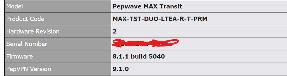

What type of device is it?
What firmware are you running?

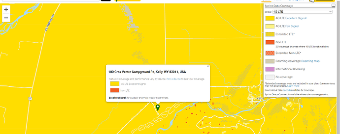

According to Sprint’s map I am supposed to have ‘Excellent LTE’ here (see image below). This also happens at other places where I am supposed to have excellent coverage such as in the middle of a city at a walmart parking lot.

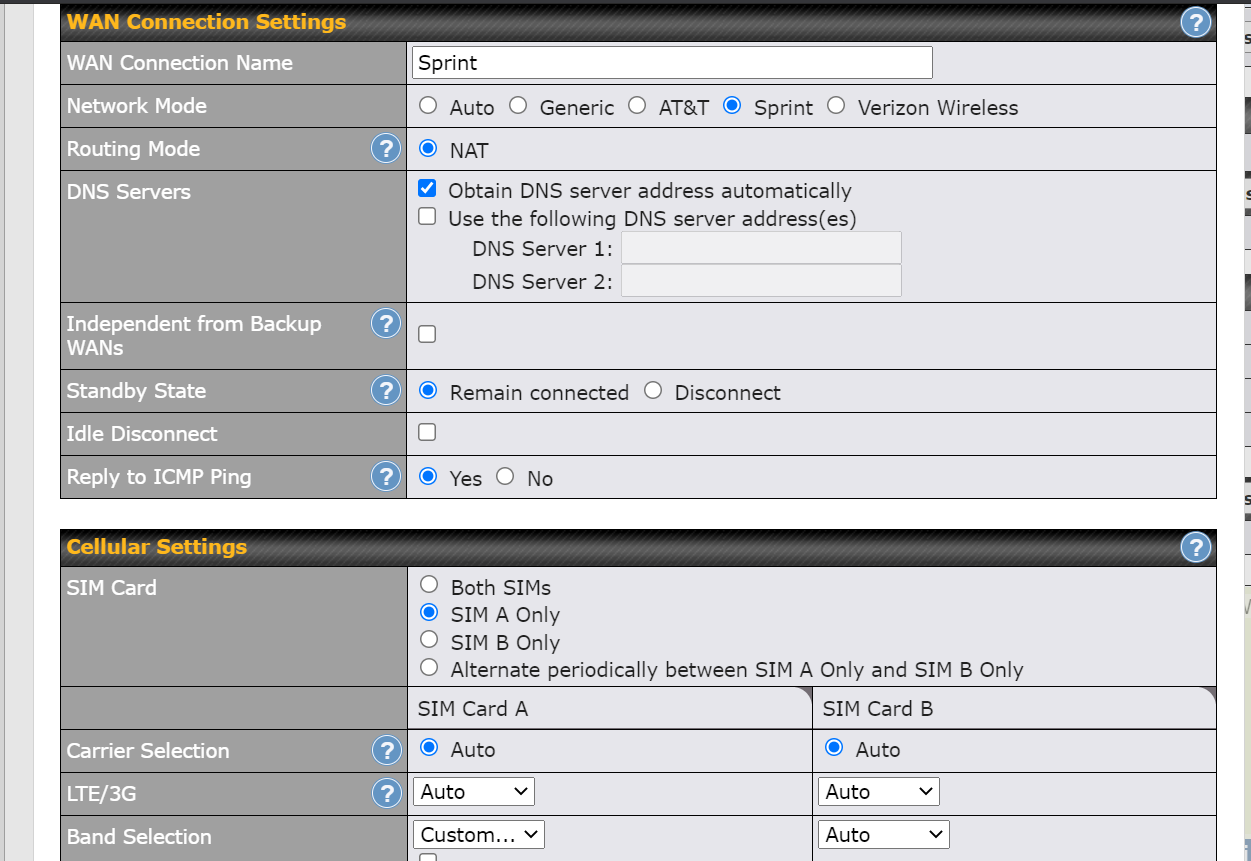

What bands does it normally connect on? Would limiting the bands help maybe?
I’m wondering what’s happening when it gets stuck if it’s picking a band the tower doesn’t like or something?
I wasn’t sure what bands it normally connects on.
But thanks to your advice, I did limit the bands to those that Tmobile and Sprint operate on, and set the type to ‘Sprint’ instead of Auto.
It immediately connected to LTE and now looks great, thanks!

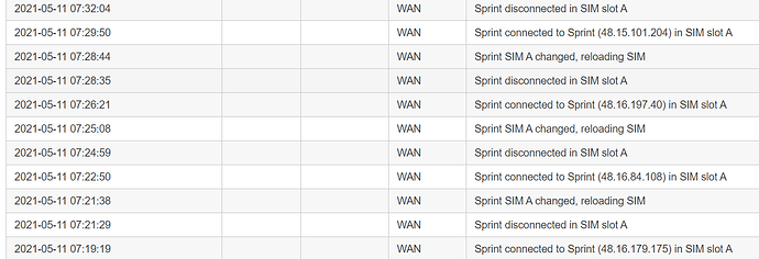

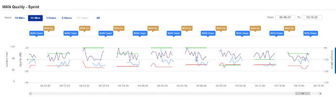

I thought all was good, but now the connection keeps dropping. Not sure what to do to diagnose. The signal strength is really good when it is up, but it looks to be dropping consistently in the same time period.
What’s the time interval that it keeps dropping if you look at the event log and uncheck all except wan it should give you good timestamps.

I have 2 sim cards, AT&T and Sprint. The AT&T stays connected. Sprint keeps disconnecting. It looks like exactly every 2 minutes with a few seconds tagged onto the end.
It is doing this when nothing is on, this was this morning before anybody was awake.
This was working just fine all of last week, I did move locations, but nothing else has changed. I tried upgrading to the firmware that was released today as well with no luck.

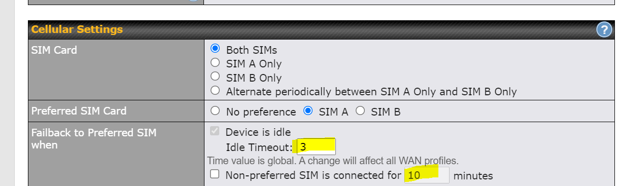

Look under your cellular details
What is your idle timeout set to?
I’d recommend something higher like 30 mins.
If you select “Both SIMs” you will then see a preferred sim option and have the timeout stuff. I don’t think that this will help you since you, like I, have TWO WANs with one sim on each.
If you select “Both SIMs” it is assumed that you have a primary and fallback sim in a single WAN connection.
