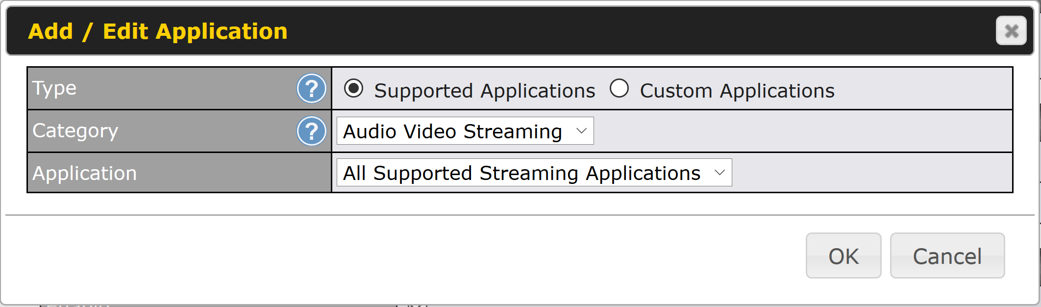

You could try to create QoS rule to prioritize the streaming traffic:
Otherwise if you know what port(s) are being used you could create a custom application as well and prioritize it.

Thanks for the reply…I tried an outband policy using one of the IPTV’s IP addresses and it did the reverse and blocked the traffic… so I will try this…
