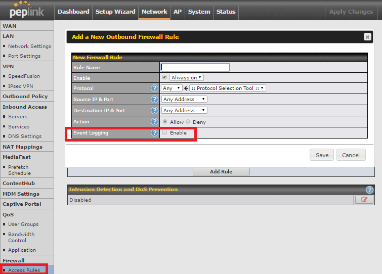

Are you referring to firewall logging for troubleshooting purposes ?
Basically you can enable firewall logging to know what traffics are accepted/rejected. For more information, please refer to the attached screenshot.
Enable firewall logging:

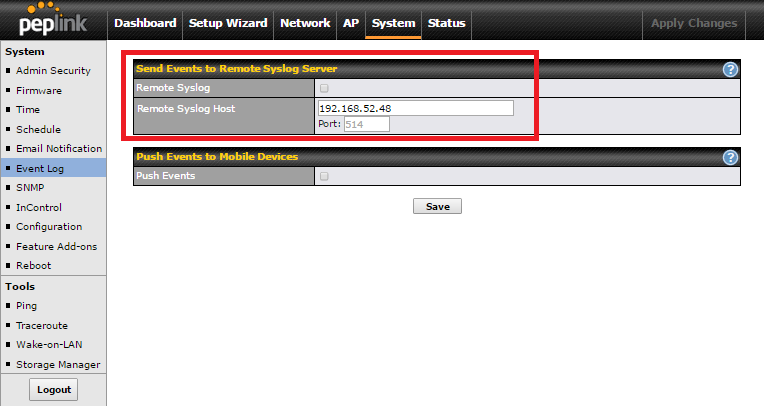

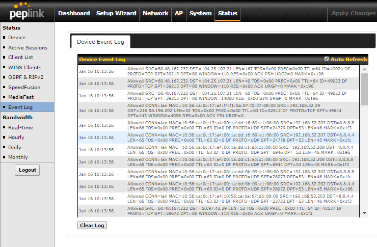

You can view the firewall logging at Event log or Remote Syslog server:
Event log
