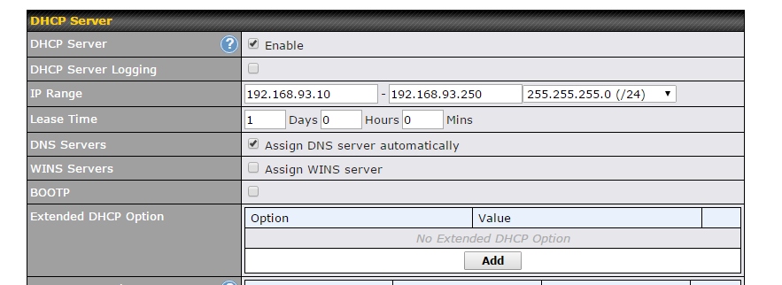

How to extend DHCP pool?
usually per dhcp pools it can only gives 2 - 254 IP address right? how can i extend my DCHP pool in peplink?
thanks:)
Hi,
Look like you are referring to extend the available IP for your network instead of just extending the DHCP pool/IP range.
  1. You must extend the LAN network for the require maximum host that need to supported.
Example: Extending from maximum 256 hosts to 512 hosts
You need to change the Subnet mask from 255.255.255.0 to 255.255.254.0
Subnet mask for 256 hosts : 192.168.93.0/24 (255.255.255.0)
Subnet mask for 512 hosts : 192.168.93.0/23 (255.255.254.0)
For more information regarding to IP subnetting please refer to the URL below:
  1. Change the DHCP IP range from
192.168.93.10 - 192.168.94.250 Subnet Mask: 255.255.254.0
Thank You

Hi,
Sorry as i may give you the wrong IP range.
You should use the following IP range for 512 hosts:
Network: 192.168.92.0/23
Broadcast: 192.168.93.255
HostMin: 192.168.92.1
HostMax: 192.168.93.254
Hosts/Net: 510
DHCP IP range can be define:
192.168.92.10 - 192.168.93.250 Subnet Mask: 255.255.254.0
You can easily calculate this by using Subnet Calculator:
http://jodies.de/ipcalc
Thank You
