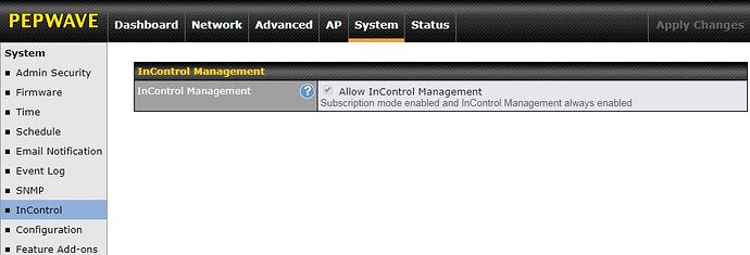

One of my HD2 is added to InControl2 before.
Now it is expired, and I can’t uncheck the box “Allow InControl Management” under System-InControl.
Also, all the internet traffic are redirected to captive portal. (I haven’t enable it!)
How can I fix it?

You should always be able to uncheck the “Allow InControl Management” checkbox when logged in locally to the device as an administrator. Are you sure you’re logged in as an admin user?
Yup, definitely log in as admin
Apart from downloading the config, unplugging the WAN and doing a factory reset then unticking the ‘Allow InControl management’ checkbox and uploading the config then reconnecting the WAN - I have No idea how you can disable this.
Lets ask @Michael for his input.
Already tried reset to factory setting, even upload to other firmware but with no luck.
It is very weird…
Anyway, thx for your advice.
Subscription mode devices are sold in a discounted price. Users are required to renew their subscription upon expiration in order continue to use them. Otherwise, they will behave exactly what Kit described.
