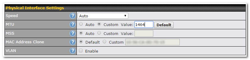

In the web interface of your Peplink router open the WAN connection details to adjust your MTU size.
If your optimum MTU size is not 1440, select Custom Value and type in your optimum MTU size.

Additionally, there is a field to specify the MSS size, or Maximum Segment Size of the WAN connection.
This value will be announced to remote TCP servers for maximum data that it can receive during the establishment of TCP connections.
When Auto is selected, MSS is dependent on the MTU value.
Some Internet servers are unable to listen to MTU setting if ICMP is filtered by firewall between the connections, in which case it could be necessary to configure the MSS settings.
The maximum segment size (MSS) is a parameter of the options field of the TCP header that specifies the largest amount of data, specified in bytes, that a computer or communications device can receive in a single TCP segment. It does not count the TCP header or the IP header (unlike, for example, the MTU for IP datagrams).
Normally, MSS is equal to MTU minus 40.
You are recommended to reduce the MSS only if changing the MTU value cannot effectively inform some remote servers to size down data size.
