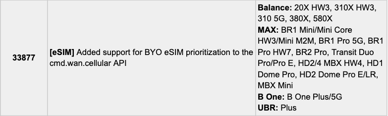

Hi! Actually this should have been added into 8.5.2 firmware, but the documentation was not updated. An excerpt from the 8.5.2 release notes:
Within the simPriority parameter, the BYO eSIMs are called “eSim1” and “eSim2”. Here is an example data body for the API call:
{“connId”:2,“simPriority”:[“1”,“2”,“speedfusionConnect5gLte”,“eSim1”,“eSim2”]}
