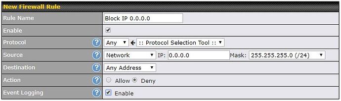

The MAC is the best option for you in this case, though you will need to combine it with a DHCP assignment. Blocking just the MAC will block them from all access.
Here is our suggestion
- Create a DHCP reservation with an invalid IP on the VLAN of the Guest Wi-Fi
- Create a Firewall rule to block all traffic with the fake IP of “0.0.0.0”
The location of the menus differs a little bit between the Balance Routers & the Pepwave MAX routers.
