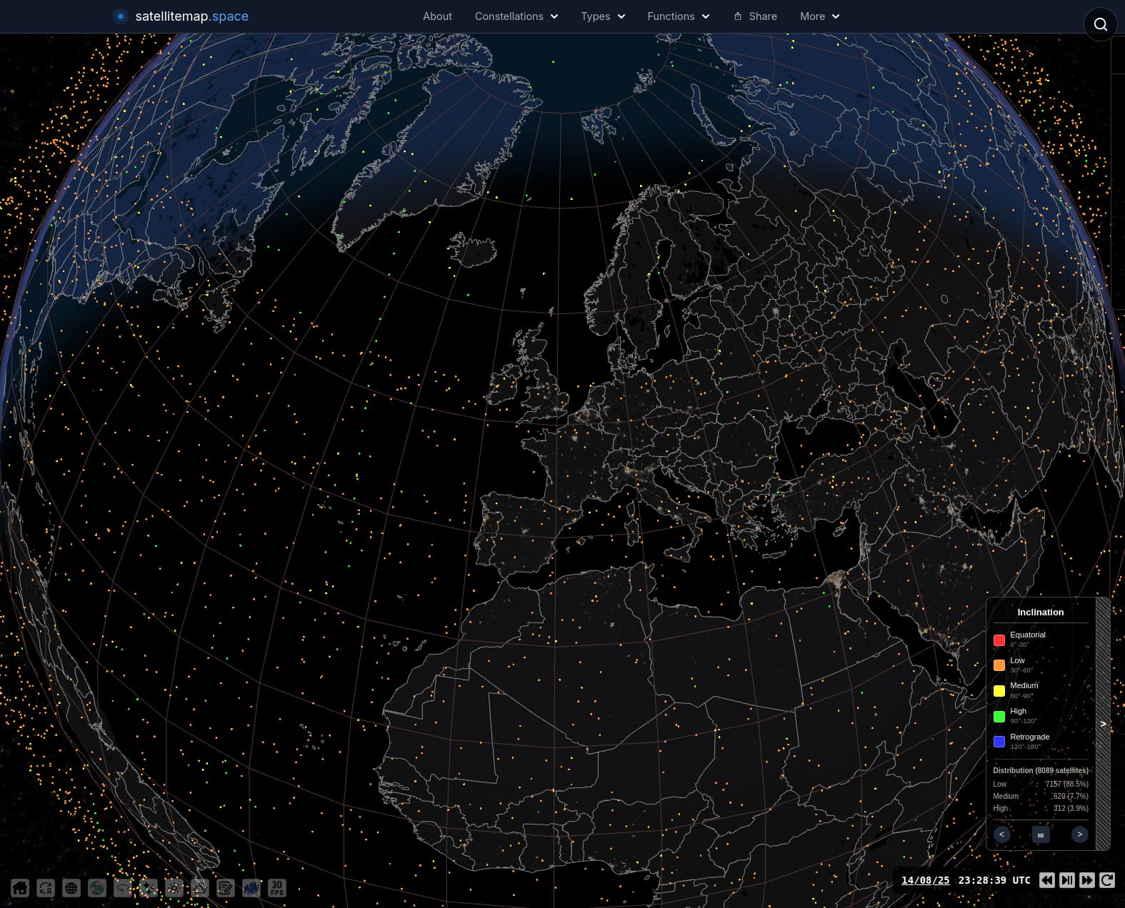

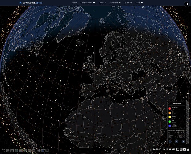

Actually, to have a few seconds of Starlink outage is not that abnormal, depending on the dish (more often with the Mini) and the location (more often on a moving vehicle, more often above 50° N or below 50° S). Today, on one particular performance dish on a sailing vessel (with 9% obstructions from the vessel construction and further clear sky / no buildings), I had two outages of 10 seconds. Yesterday I had 8 of them. I use PING tests to 1.1.1.1 and 8.8.8.8 as health check.
Speedfusion helps a lot to overcome these with 4G or a second Starlink dish (with different orientation).
See the Starlink coverage map https://satellitemap.space/ to see the difference in density once you move further towards the poles:
