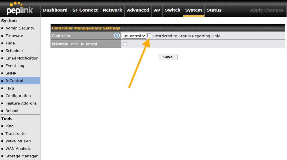

Hello André,
There are several factors that can prevent InControl2 from being pushed out to Peplink devices, including settings on the Peplink device that effectively put it into monitoring-only mode.
Have a look at the local devices web admin (under System / InControl) and check that the settings are as shown here, with “Controller” set to “InControl” and “Restricted to Status Reporting Only” unticked.

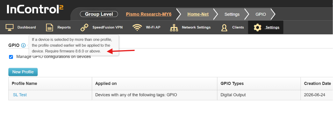

@AndFor ,
Found that issue. Device need to have firmware 8.6.0 to support the feature.
Super, that explains it :+1:
We’ll most likely update one test router for the beta and then await the release of 8.6.0, thank you for the swift response :slight_smile:
