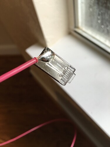

So here is how I did it myself.
  1. Get a shielded RJ45 male connector. Crimp it closed.
  2. Solder on a 14 AWG ground wire. Stranded wire is easier to solder.
  3. Plug into an unused LAN port at which point your connector will connect to the shielding of all the RJ45 connectors which is connected to the ground plane of the PCB inside the device.
  4. Connect 14AWG ground wires to your equipment rack bonding block.
  5. Repeat for redundancy.
See photos
