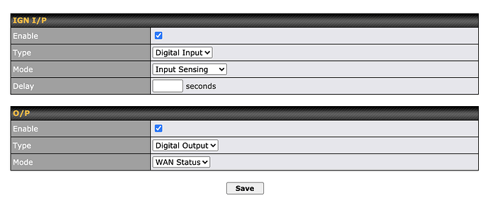

@PeterWest Which model you are using? From my MBX, you have GPIO settings under Advanced. Can see below capture for reference:
In brief, when the digital input detects high/low as a state change, there will be an event trigger both on the device and IC2. Then you can use the event to achieve the desired solution.
@Ricardas can help to follow up with you and the setup.
