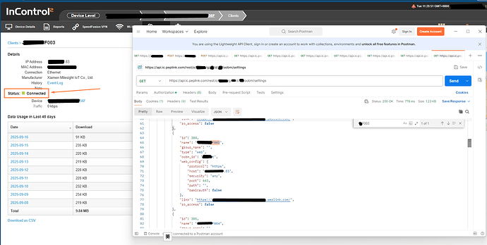

Hello,
I’m new to Peplink InControl and currently exploring its API capabilities.
I’m trying to find an API that can retrieve the online/offline status of third-party devices connected via InTouch. I’ve reviewed the InControl API documentation but could only find an endpoint that lists all InTouch devices – InControl2 REST interface overview — not one that provides their connection status.
Could anyone advise how to achieve this? Any guidance would be greatly appreciated.
Best regards,
MC

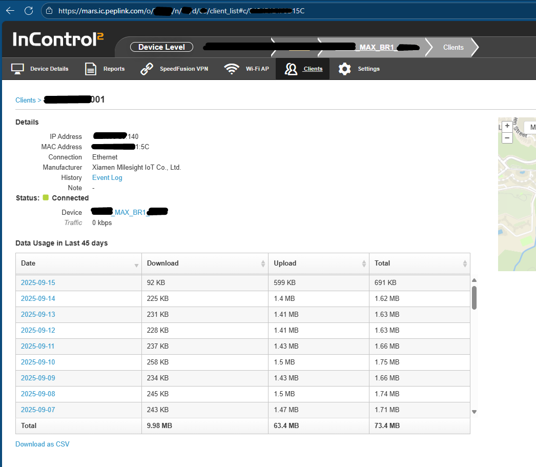

Note: The InControl2 web portal displays the connection status of InTouch devices (e.g., “Connected”), but I haven’t been able to locate similar information through the API.

Hello Jonathan,
Thank you for the input.

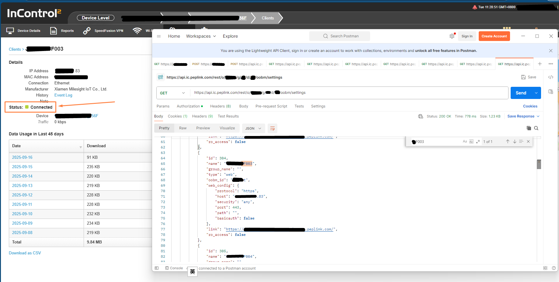

I have tried using the API, but it seems that the ‘connection status’ information is missing from the JSON response. Although the InControl2 web portal clearly shows the status of InTouch-connected devices (e.g., “Connected”), I have not been able to find a corresponding field in the API output.
Is there a way to retrieve this status via the API, or is it currently unavailable?
Again, thank you for your time and help.
