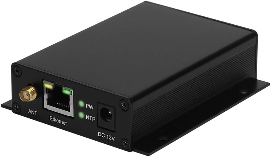

Maybe one of these affordable devices is my best bet and I could get data from it to the internet via the B One router, but it’s far from clear the B One would interface with it and get it’s own GPS coordinates from it??
https://fc-ntp-100.toimii.fi/
Seems to be marketed as an NTP server, BUT also seems to support NMEA??
"NMEA0183 receiver
Addition to NTP-functionality device has NMEA output on tcp/4001. It seems that there can be only one connection to tcp/4001 at same time."
So to add to my confusion, it seem to output NMEA on TCP port 4001, at least by default, but Peplink routers seem to expect it on 60660? IF I could even enable that on the B One? It’s mentioned in the B One manual, but that almost seems to be copied from another original source?

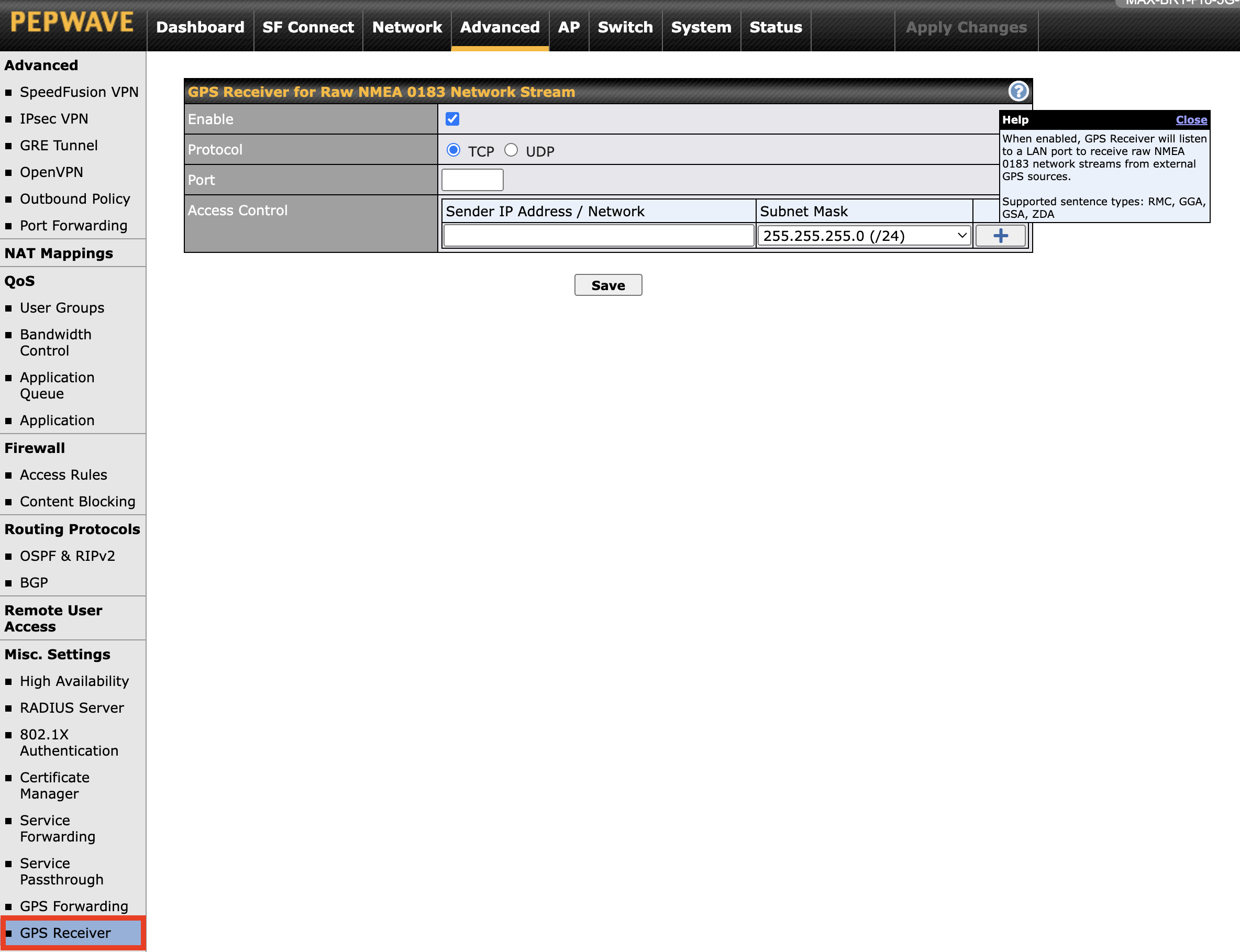

Does the B One not have the “GPS Receiver” option in Advanced settings?
Sadly, no, it does not. Seems the reference to port 60660 in the B One series manual is just for general Peplink router reference, or was pasted in erroneously from other documentation when the B One manual was written. Or there was intentions or perhaps still are plans to implement it, but that hasn’t happened as of 8.5.2?
I only see:

Yes it does. It’s at this url on a B One with 8.5.1 build 5714
/cgi-bin/MANGA/index.cgi?mode=config&option=gpsreceive
But there might be a UI bug I think were its only visible if you set a WAN to be a ‘Starlink WAN’ in Network > WAN | Starlink
Ha!! How about THAT! I actually came across a post referring to this exact same issue the other day and did make that change to WAN1 and it still wasn’t showing the GPS Receiver in Advanced Misc. I thought it might be because my Starlink it not currently connected. I need to finish the roof mount for it, a POE cable has been run through a blister for the Starlink already.
But seeing your reply here I just logged into the router and before I did anything I happened to notice it says there were changed to apply. So I hit the Apply button on that message and SURE ENOUGH, now under Advanced Misc. I see:
  • GPS Receiver
And clicking on that brings me to the URL you listed. And it says:
GPS Receiver for Raw NMEA 0183 Network Stream
And has an enable check box.
Nice!
But I am pretty sure I DID apply that setting, so it’s strange it stayed unapplied?

The webui dashboard will show a map if it has a gps location.
Is the app trying to push? The GPS Receiver configuration is for setting the router to pull from the GPS source. So you’d need to give the router your mobile’s IP address when it is connected to the router.
Or maybe port 60660 is also listening now, and you’d have to put in your router’s IP and that port in the Android app to push to.
What Android app are you using?
