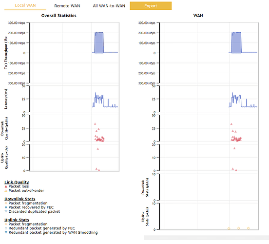

Here is the balance side:
I agree on the marketing figure, but at around 500 Mbit/s I wouldn’t have wondered.
Test done in download on the server (upload for the balance)
Sur le 310x, le WAN Analyse :
I would do the test from home, it is another provider
Thx for your help
