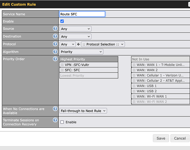

I do something similar to force all data to a Vultr server, but I take it a step further. If Vultr goes down, I route all the data through the regular connected SFC path, which is always connected but idle to maintain the connection bonding.
This is configured on the device under Advanced/Outbound Policy, likely as your first rule on the list.
