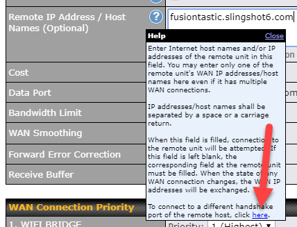

On your balance you’d then edit the PepVPN profile to your FusionHub and click the blue ? icon next to the Remote IP Address bit then the here link:
You can then enter a custom handshake port in the box that appears:

Unfortunately, the port set under the advanced options is the data port, not the handshake port.
The handshake port is global to the device, so cannot be set in the profile.
In this case, I’d probably fallback on the firmware configuration to test if a blocked handshake port is actually your root cause.
