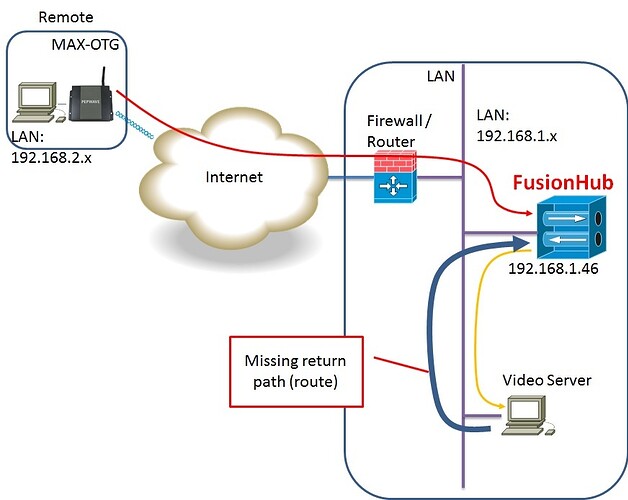

But I’m not been able to access nothing that is in the internal network. I got a video streaming server running on the same machine as FusionHUB. But somehow, even after enabling**“SpeedFusion Peers Access Internal Network”**
I can’t access it, I can’t even ping it, from the MAX-OTG.
On the MAX-OTG I can ping the FusionHub server (on 192.168.1.46)
but I can’t ping or access any other machine on the same network (192.168.1.x)

Hi Pedro
We think the “ping” request can reach the other machine, i.e. video server, on the same network as FusionHub (you may turn on wireshark / tcpdump in the video server to confirm this). However, there is missing return route from the machine back to FusionHub, and this caused the “ping” reply can’t be returned. So, please add a static return route in the machine.
In Windows, the command is “route add <MOTG LAN’s network> <MOTG LAN’s netmask> <FusionHub’s local IP>”.
Example command: > route add 192.168.2.0 mask 255.255.255.0 192.168.1.46 (assuming MOTG LAN’s network is 192.168.2.x)

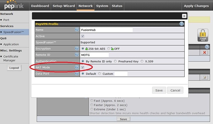

Hi Pedro
If network access is always made from remote (MOTG) to Video Server side, there is another simpler way to make this work without manually adding route. You can just check the “NAT” mode in PepVPN profile at FusionHub (see below)

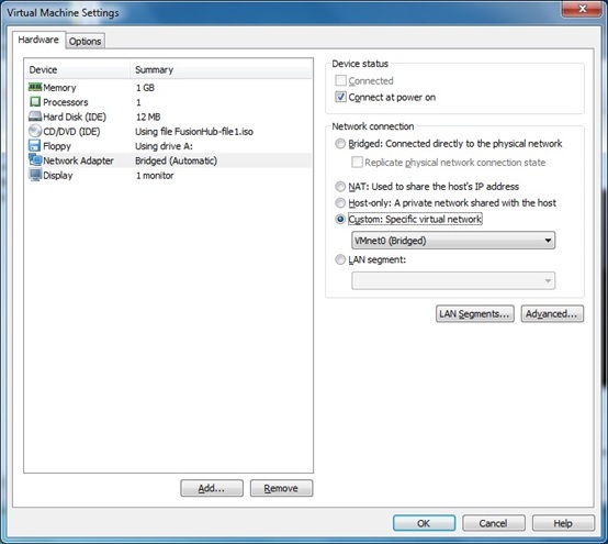

  2. Open VM’s “Edit virtual machine settings”
  1. Configure the existing “Network Adapter” to use “Custom” and with “VMnet0(Bridged)”

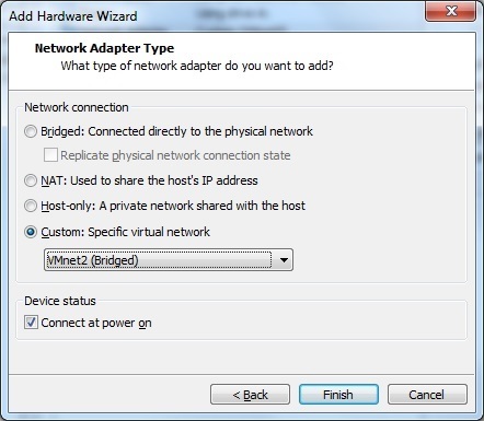

  2. Use “Add Hardware Wizard” to add a new “Network Adapter”
  1. In the Network Adapter Type setting, select “Custom” and with “VMnet2(Bridged)” and check “Connect at power on”.

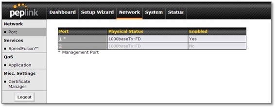

  2. Once the above are done, start the VM and you will see two "Port"s are shown in FusionHub’s Network Port setting. You can now use one port for WAN and one port for LAN

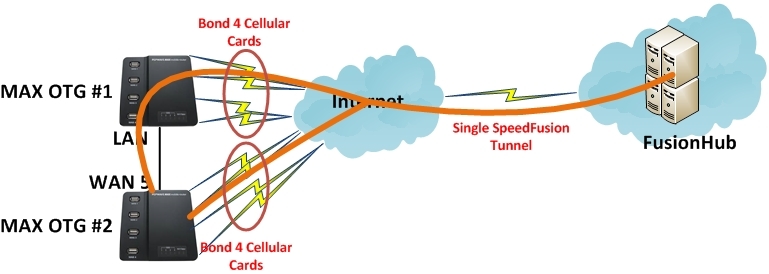

MOTG bonds upto 4 cellular cards. If we want to bond more than 4 cellular cards can we have 2 MOTG working in tandem with one of them acting as a WAN input for the second one through its LAN port?
What suggestions do you have for such a scenario? Will it work and how to achieve this?

Hi Rafat,
I believe you are looking at possibility to cascade 2 MOTG, so you can connect up to maximum of 8 cellular cards, and combine these links into single SpeedFusion Bonding VPN tunnel.
So, physically I am assuming MOTG #1 will hook up 4 cellular cards, and it’s LAN port will connect to MOTG #2 WAN 5, and MOTG #2 also connected with 4 cellular cards, as illustrated below.
If the requirement is outbound load balancing, this should be working. But if you need to establish single SpeedFusion Bonded VPN tunnel from MOTG #2 to FusionHub (with total 8 cellular cards bandwidth) as shown in above diagram, that would need some exploration.
One more thing to clarify, your intention is to combine as much cellular cards as possible (in this case would be 8) so you can have bigger upload bandwidth for the video streaming traffic. Is my understanding correct?

Hi,
Actually we need to establish single Speed Fusion Bonded VPN Tunnel from MOTG #2 to Fusion Hub (With Total 8 Cellular Cards Bandwidth).
Yes we need to combine and aggregate as many cellular cards as possible as we need bigger upload bandwidth for Video Streaming traffic.
Please suggest the best way to achieve this
