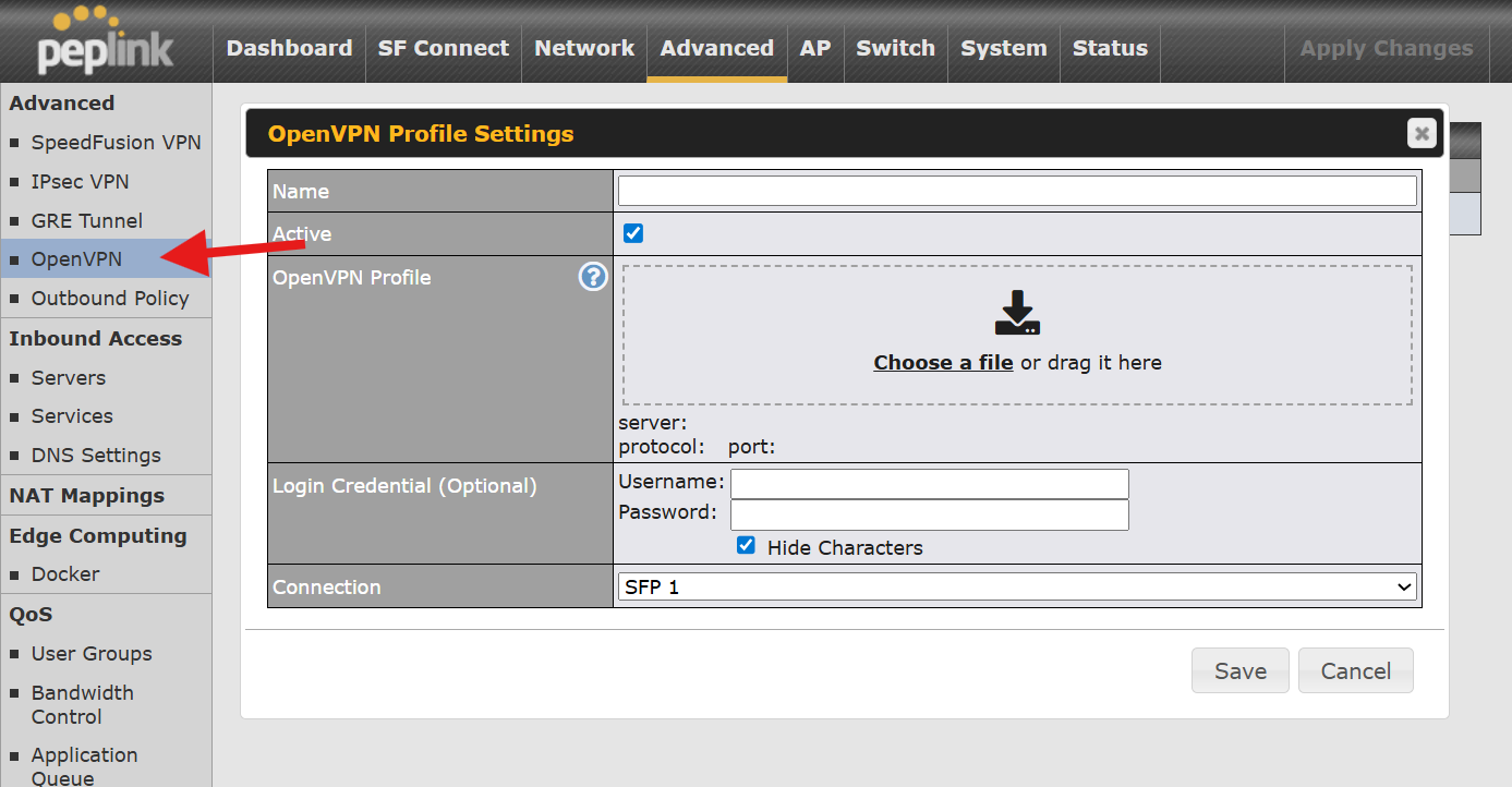

I have one last question:
The OpenVPN setting under the tab “Advanced OpenVPN” remains Off?
This is how mine looks.
