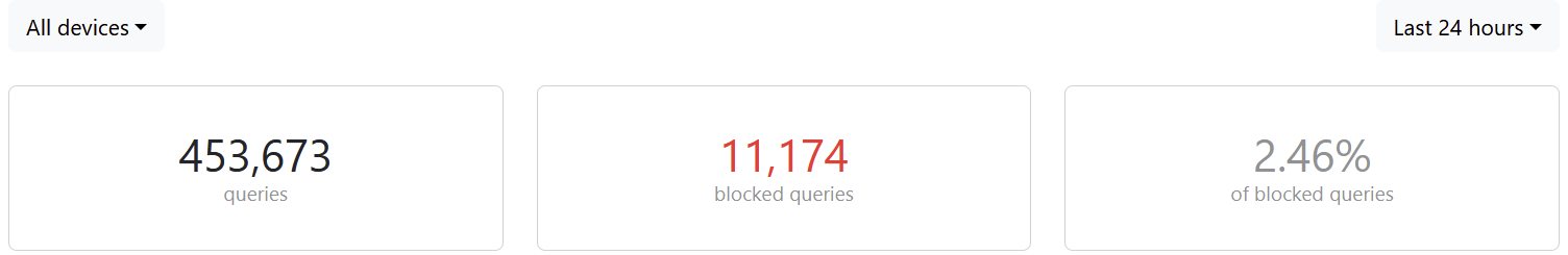

Can confirm the same issue (NextDNS DoH Failing).
I might mention we have not had that experience. As I write this I’m looking at an NextDNS account that has a B20X and a B310X on it, both running 8.5.3, and both are resolving fine. At least as of now. ;<)
