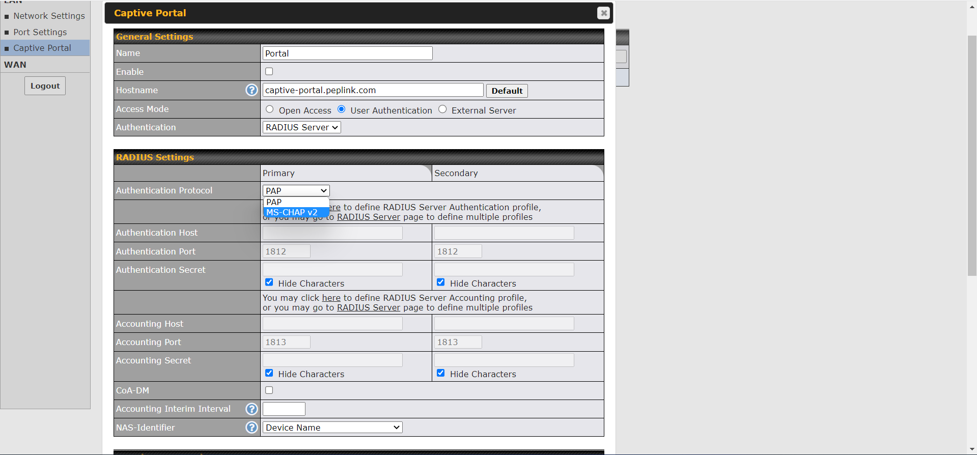

Reference 26060: [Beta 1] [Captive Portal] Added MSCHAPv2 for RADIUS Authentication
Could I get some more info on this? I am very keen to be able to use radius as an authentication method for captive portals…

Please refer to the screenshot below. MSCHAPv2 is supported for RADIUS Authentication for Captive Portal
Thanks- will this be configurable in Incontrol?

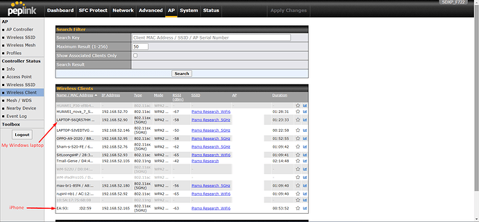

I’m using the MAX BR1 Pro 5G and I do not have this issue. I see clients connected via 802.11ax, 802.11ac and 802.11na.
TU. I am thinking it may be due to the AP FW in use, 3.9.2s007. I see another location where 3.9.1 is in use that seems fine. Thanks for the sanity check.
