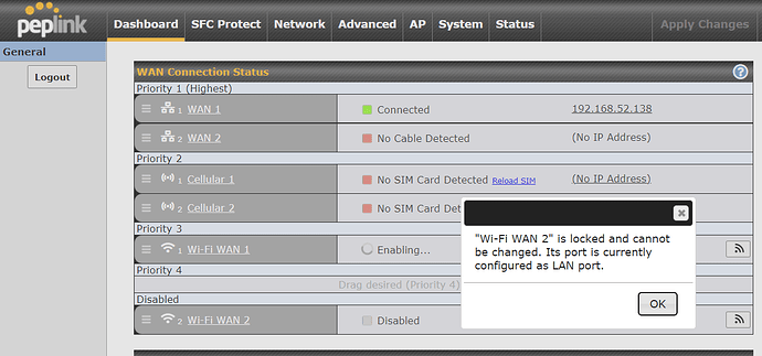

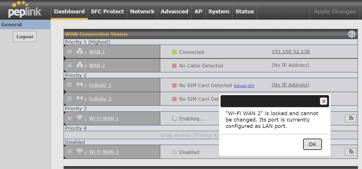

This is expected WebAdmin design. Although the Wi-Fi WAN 2 is shown in the Dashboard, it’s been locked. You can’t enable the Wi-Fi WAN2 in WAN + AP mode
Which device you are seeing this ? Possible for me to check on that ? I tested with my device and I can’t reproduce this. Possible this is related to the Browser settings ?

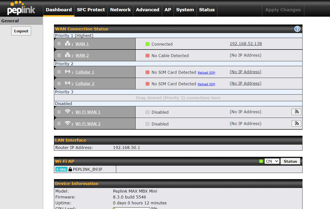

German translation prompt shows on
380x HW1 8.3.0 build 5546 Serial Number xxxx-xxxx-18C3 via local ip login
20x HW2 8.3.0 build 5293 Serial Number xxxx-xxxx-65FF via ic2 RWA
I’ll raise a ticket.

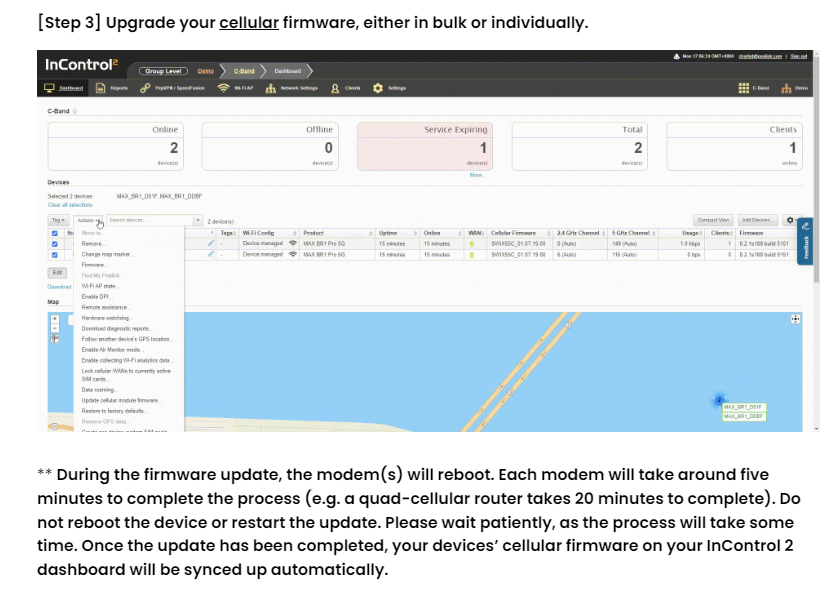

Does 8.3.0 include the c-band firmware, or will we still need to install it separately?
Yes, 8.3.0 included the C-band support. After upgrade the device using the firmware 8.3.0, you can initiate the Cellular firmware upgrade by follow the [Step 3] here .
So, I need to do 2 steps? Upgrade to 8.3. AND install the special firmware?
No need to use the special firmware.
What you need to do :
- Upgrade the device using 8.3.0.
- Upgrade the Cellular module firmware by referring the Steps 3 :

Finally we able to reproduce this. Chrome “Google Translate” seen like treating the Status —> Device MAC address info as “German” language. Engineering team will check on this.
Again Thank you for all the help !!! ^^
can you please open a ticket to allow support team to check ?
Done.
