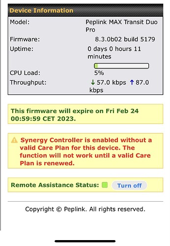

I can’t enable Synergy Mode on my Transit Pro despite having PrimeCare subscription active.
please find a Screen from web admin below:
@jakub.nowicki to my knowledge peplink has not even provided instructions or an actual way for customers to use Synergy yet. an error message about primecare being require for synergy is superfluous.
I have primecare - dont have this error and its not usable for me yet either.
when will we actually be able to use that feature? am I missing something?
