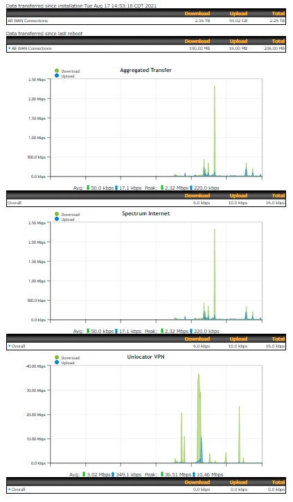

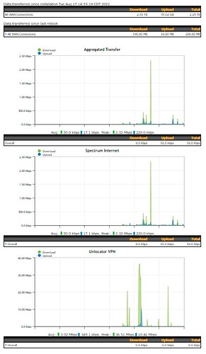

OpenVPN is not connecting to my external VPN with my Balance 20X on Beta 2. The data presentation on the real-time chart is not showing the OpenVPN in the aggregate data. It appears this new firmware is ignoring my Outbound Policy.
